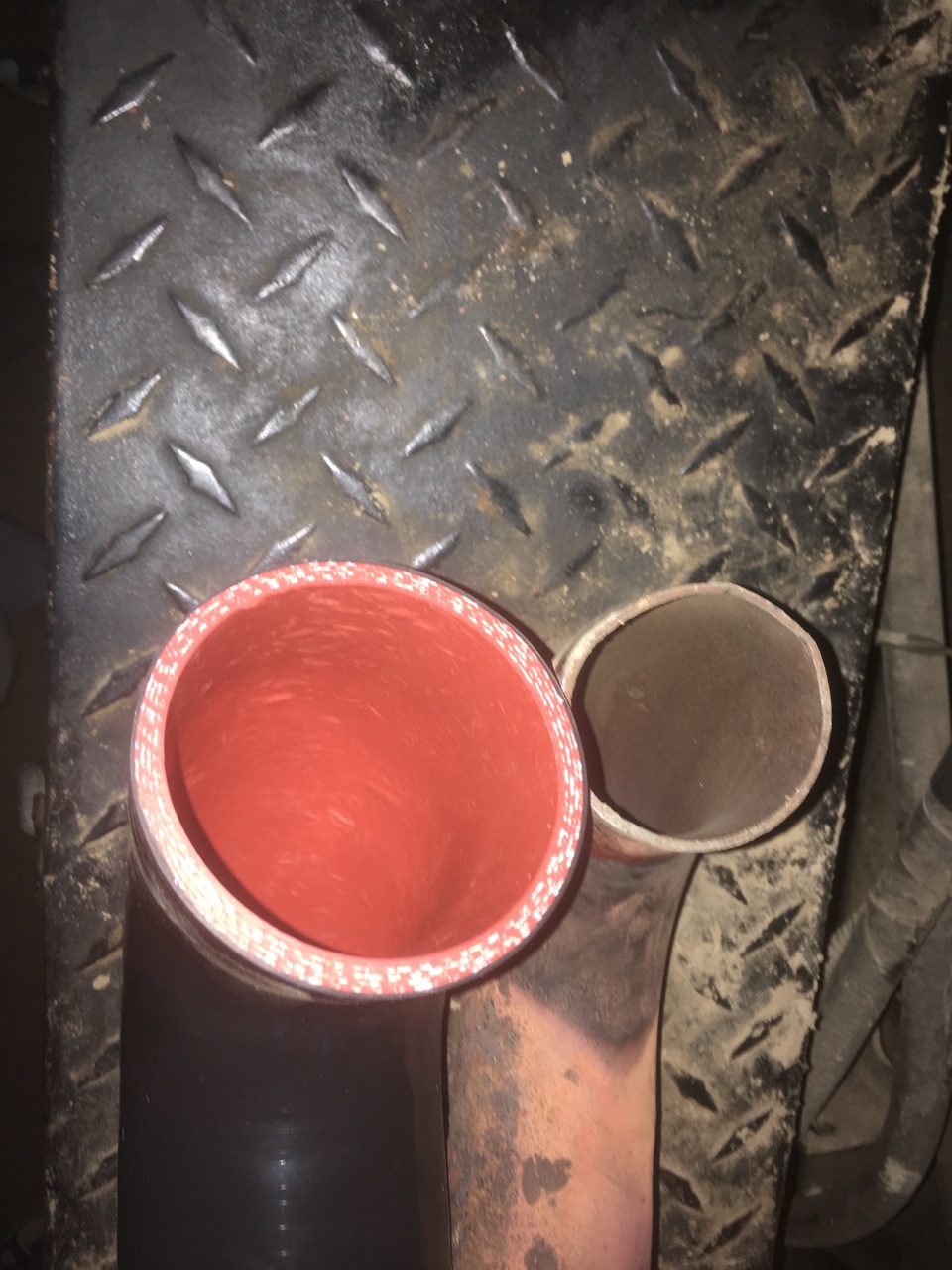

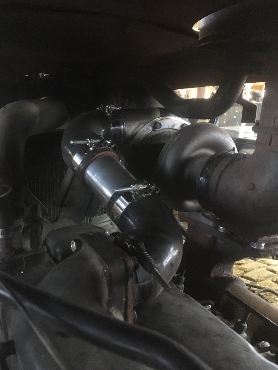

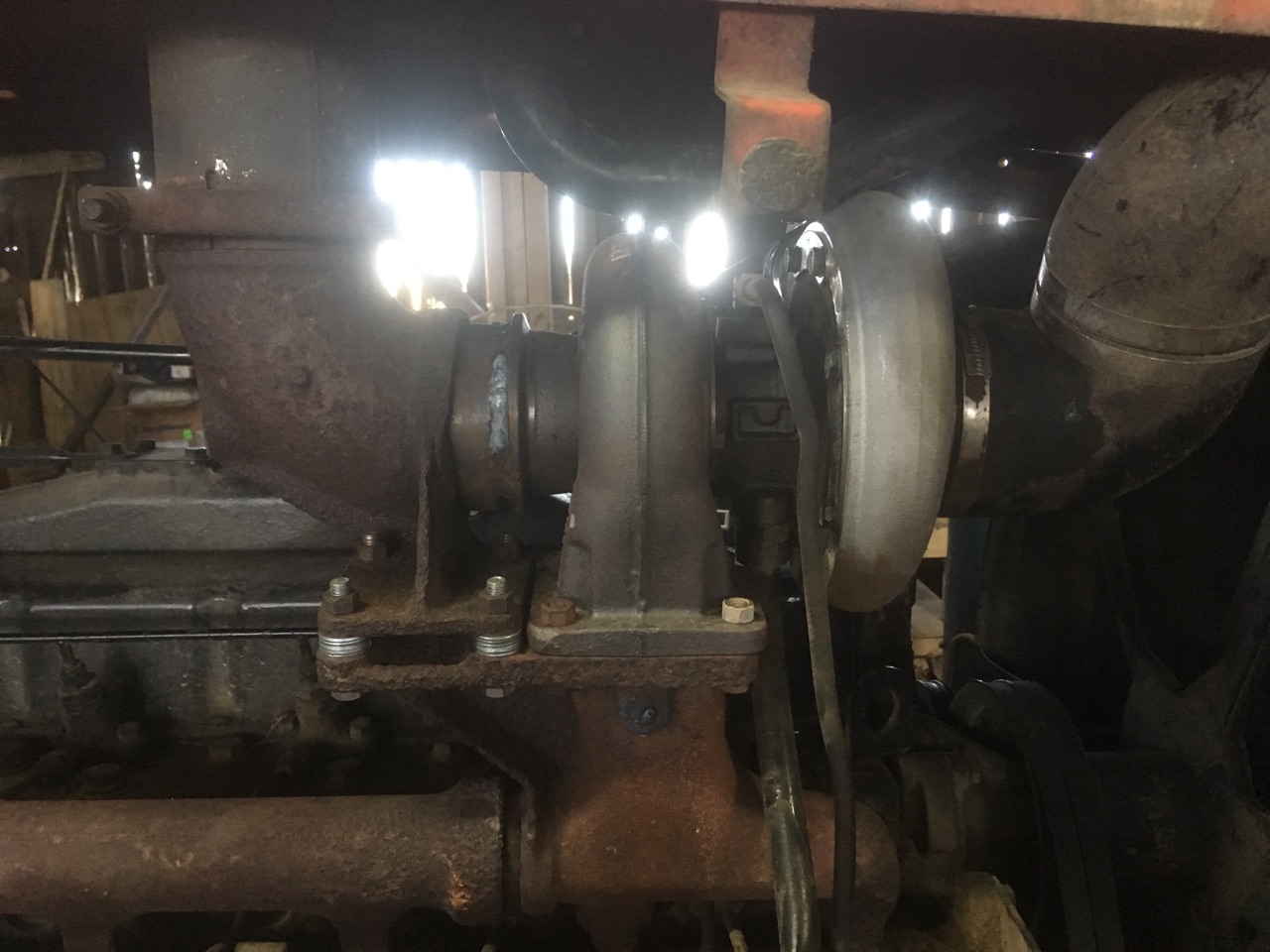

Posted By: Calvin Schmidt
Date Posted: 16 Jan 2019 at 6:26am
I have a "On Highway " spec engine in my 220. It has a Simms injector pump and the same injectors tips as a 7080. I added an intercooler and the large waterpump which is necessary to get proper circulation through the intercooler. This required moving the lower rad inlet to the left side and in the process the rad was recored with 7 - 1/2" rows. With the stock pump setting, it dynos 190 hp. I can pull a 24' AC 1400 cultivator all day in 6th gear with no overheating problems

Posted By: tornado8070
Date Posted: 16 Jan 2019 at 7:05am
Finally someone did which in my opinion is the most gained aid in keeping them cool. Recoring and adding the 7th row of tubes. A no brainer for $150 to add 15% cooling compacity.

Posted By: shieldslx13
Date Posted: 09 Apr 2019 at 7:26pm
Date Posted: 09 Apr 2019 at 7:28pm
Finally got rid of the garden hose that was running to the ic
Date Posted: 09 Apr 2019 at 9:38pm
Old vs new intake crossover
