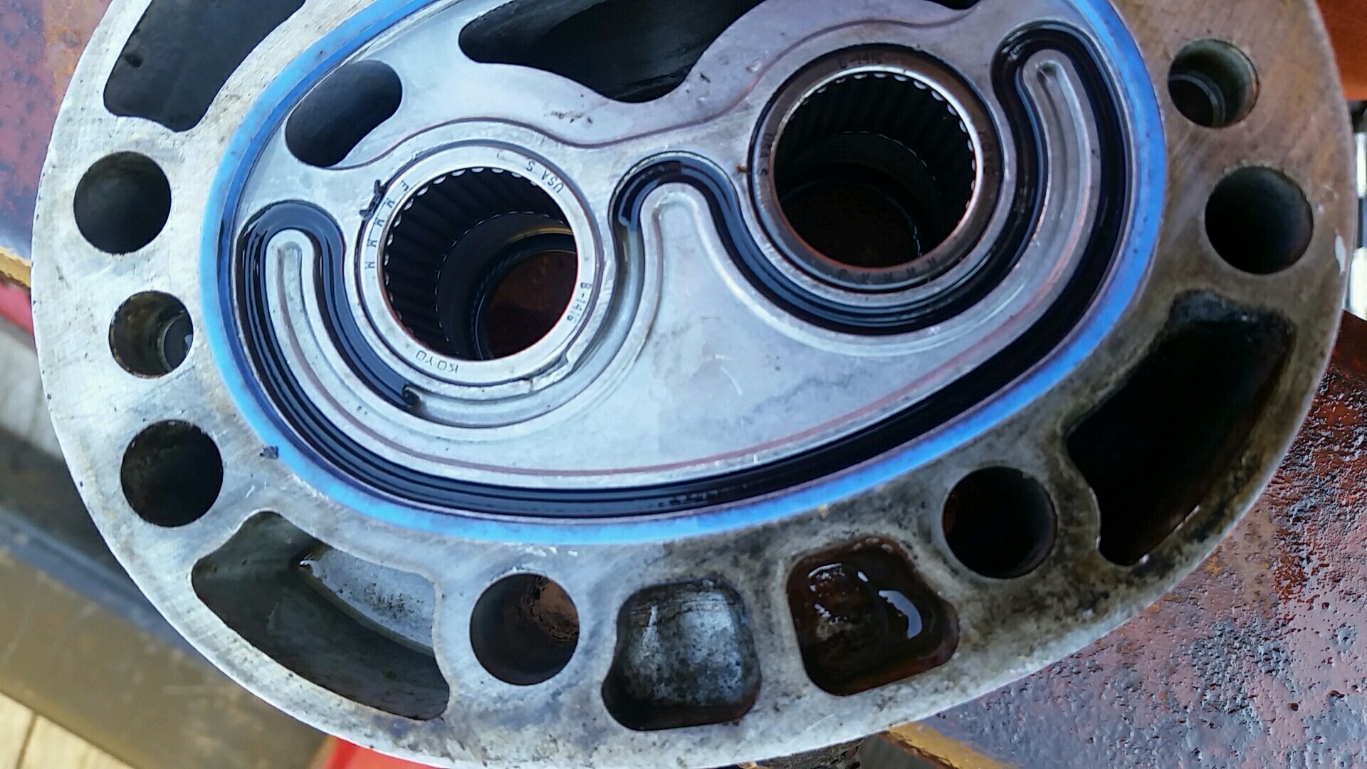

I'm no hydraulic pump expert but behind one of the main wear plates the aluminum housing next to the bearing is cracked out and the seal is blown out. Could this be part of the problem? Lol

Date Posted: 29 Aug 2018 at 6:00pm
That's not going to work that way...
Posted By: DrAllis
Date Posted: 30 Aug 2018 at 7:09am
That is your problem.

There is a piece of the housing missing right where the blue seal blew out.

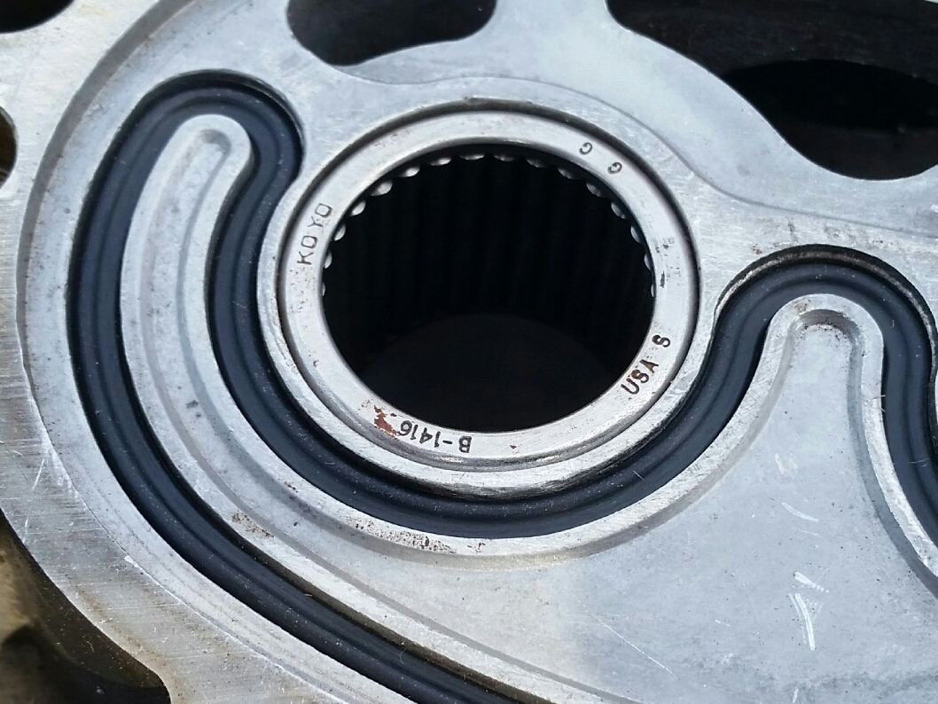

Had a local guy tig weld up the pump section. Then I dressed it up with a die grinder and pressed in a new bearing. New preload and load seal and it's back in business. Lifts the baler and discbine without trouble. Adjusted the relief back to factory spec so all should be good.
Posted By: chevytaHOE5674
Date Posted: 15 Sep 2018 at 3:09pm
Posted By: chaskaduo
Date Posted: 15 Sep 2018 at 3:31pm
The finished repair picture really adds to this topic.
