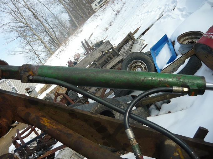

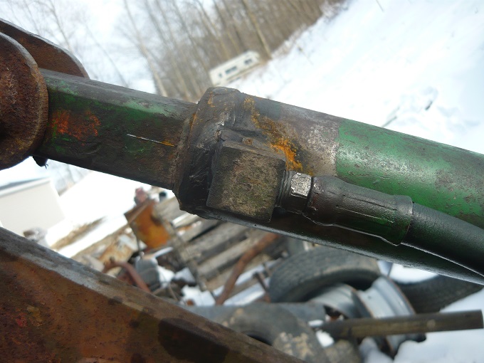

here's a couple of pics of the cylinders I had reworked

Okay, so what you've got here...
Your original cylinder was a SINGLE ACTING cylinder... that means it used return force to push back to the other end.  There's obviously a difference in the plumbing, there's also a difference in the piston seal.  The piston of a single-acting acts like the seal in an engine- compression/combustion pressure forces it to seat and seal.  Return stroke though... it doesn't.
on the hydraulic cylinder, a simple 'cup' seal (like what's used in many water wells) seals by pressure, and slides basically 'free' without it.
And the piston is MADE for the type of seal application.
You've got the wrong piston and seal.
If it were in my garage, I'd take it apart, remove the piston, and find an appropriate piston/seal to put in it's place.  Frequently, the piston head is held to the rod with a large locknut.  Yours is probably serviceable (if they used a removable end packing), and if so, pull one apart, get a good look at the piston.
DON'T HAVE ONE MADE BY THE MACHINE SHOP!
Look at Bailey's, and other hydraulics supply places... they have standard piston sizes... you can get one with matching seals off their CNC line for substantially less than local machine shop.  You MIGHT hafta have the machine shop bore it to custom-fit your rods, but there's a good chance you'll find a bolt-on solution.
I wouldn't be too sore at the machine shop for doing what you asked... that guy may not have had a clue about hydraulic piston head/seal, or he may have thought you WANTED it that way.  See, there are many machines that use SINGLE ACTING cylinders with TWO HOSES.  Why two hoses?  several reasons:
1: Because they use the volumetric offset to keep reservoir size down
2: Allows the hydraulic system to bleed itself rapidly
3: Allows the cylinder to ACT like a dual, but without having pressure (think gentle handling of a hay bale, or float function of a ground implement) applied on the return stroke.
4:  Allows the cylinder to be used as a variable-rate DAMPER
An excellent example of this function is a cylinder set up for this intentionally on a vertical metal-cutting bandsaw... it will only lower-so-fast.
Don't sweat it- be patient, you'll find a reasonable fix. Wink
