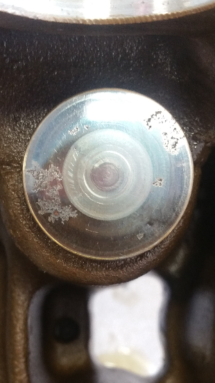

I think the most important part to this is as collectors our tractors sit more than they run....through the changing temperatures of the season's and just time itself the oil starts to run off of the steel parts inside, the next time we start the engine it runs without sufficient lubrication on the surfaces for a period of time due to the oil being cold and having a thicker viscosity or maybe due to the older lubricating system and that it's just not there yet. The cam lobes and followers can start to develop small amounts of corrosion that runs into Spalling on the followers and surface delamination on the tips of the cam lobes....this is where the zink kicks in to protect this all. I agree with the above responses if we wouldn't be using advanced exhaust systems with O2 sensors and electronics we would still be using oils that are more zink fortified.
Another topic is starting....people say well I just start it for a few minutes a couple times a year so I know I'm good.....Well, this may be causing more harm than good. As the engine starts to warm up condensation is made due to temperature differentials, this could be worse on a cooler day for example....unless you get the engine to full operating temp to completely burn off any condensation that has been introduced into the crankcase u may be shutting the engine down with small amounts of moisture inside that will induce rust more than if you'd of left it alone until the next time you were going to run it for a longer period of time.
Posted By: DakotaSteve
Date Posted: 12 Feb 2018 at 9:13am
Here are a couple pics I took of cam follower Spalling. This engine sat without running more than it ran but was used every year.

x3 steve on your last two posts!! this was the point of my two threads on this subject.just trying to save us all some grief down the road.

Ford in fact is still using flat tappets in 4 and some 6 cylinder engines. Just did a water pump on a 3.5L Explorer. Driven by the timing chain so the front cover has to come off along with the cam covers. Cadillac North Star is also flat tappet.
The ZDDP and zinc may have been reduced in modern oil, but the friction modifier package has been changed too.
Take another look Steve. That left pic is rust pits without question, the right one the lifter stopped spinning.
Date Posted: 12 Feb 2018 at 1:14pm
Brian, yes I agree. I personally feel that the zink in the oil helps prevent things like "Rust".
Engines that sit more than they are ran can use anything that's in their favor to help their longevity.
Oils have been discussed and discussed for many years....I'm sure that won't change. I think as long as the info is out there folks can pic and choose what they believe in and what suits them.
