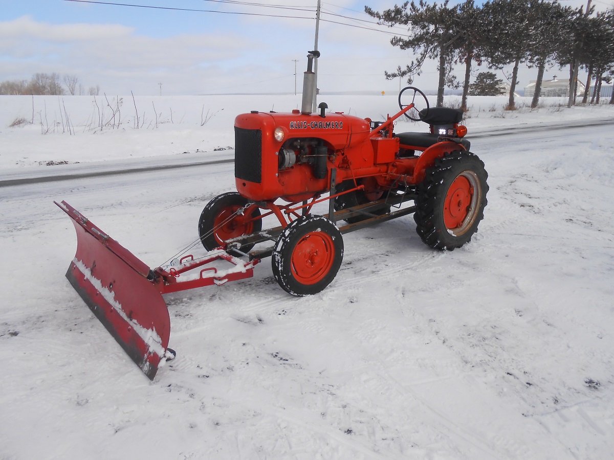

The snow that is... I'm ready now!

Dang, Ben, if we got that much snow, a disaster state would be declared and the state shut down! (No joke!)
Really nice blade! Been wanting to build a blade for my B or 8N for years, but we only get enough snow to use one about every 5 years or more. Lol
Does your B have good traction pushing much snow with that?
Also, maybe I'm missing something, but what power source moves the cable? Winch?
LOL! I hear ya', we have family in VA, same thing... 2in and the city shuts down. This is NOTHING for us, it all melted a week ago. SmileWink
It pushed everything in front of it except the re-frozen snow, only traction issue I had was when I was trying to back up uphill with the blade up.
Yeah, it's a winch, 2500 lb Badland from the HF cheapo stores. Wink I want to put a hydralic system on it, but that was going to be more than I have into the whole system at the moment.... Next year/ this fall maybe!

Nice! Your tractor is 12V, so that sounds like the easiest/cheapest option. If I had one, I'd like to use my hydraulic ram to raise/lower it, (Still running 6V system). So far, the method by which I'd do that is still in the thought process.

Nice and no means to be critical, but if you brought the plow a bit closer to the tractor it would take less "lift" off the rear when the blade is up (a little better traction) and also would put less strain on the lift system. Otherwise, nice unit.

I thought about that as well. But...doesn't it need to be some distance out, so the blade can be fully angled without hitting the tires?
Yeah, it worked out good. And also, I didn't want a non-live lift system, that
would drive me nuts.  I believe that I saw one like that once, if you are talking on the rear, they used a pulley where I have my winch...
Yeah, I just used the frame as it came off the truck, I kinda like it way out there, but it could probably come back another 8-12 inches without a problem. Tires are out of the way enough to not be a problem.

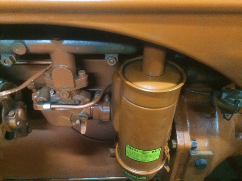

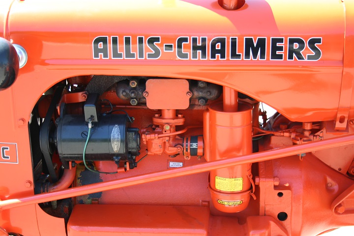

IS the fuel line correct on your tractor?   I have a CA and the fuel line goes outside the oil bath air cleaner like yours does.   I always thought it should go behind it.   Not that it is a big deal, just wondering what is correct.   Thanks... Oh and very nice snow mover.  Have fun playing, i mean working in the snow.
Posted By: jaybmiller
Date Posted: 06 Feb 2018 at 12:36pm
Should probably go behind, I know my D-14s are.'kept out of harms way'
As far as I know it is, I can look at the pictures in my owners manual when i get home though and see where it is. Probably Gerald J or Dave Kamp would know, maybe they will let us know before then. Smile
Thanks, I will! Clap

Posted By: ac45dave
Date Posted: 22 Feb 2018 at 8:55pm
Hey Ben,Creston, does this help?I know it's a "c" but I think they were the same.
Posted By: BenGiBoy
Date Posted: 23 Feb 2018 at 2:05pm
Yep! Mine was on the outside when I bought it, I never thought that it should have been on the inside! It makes sense though.
Thanks for the pic ac45dave....I think that the "c" is exactly the same as a "B" up front except for the tricycle front, but I could be wrong. Either way, I assume that it should be the same on my "B"....

CrestonM sent me this pic:

Posted By: CrestonM
Date Posted: 03 Mar 2018 at 7:44pm
Thanks, Ben!
If you'll notice, there are 2 different oranges...the orange on the air cleaner is what I would consider PO1. The carb was repainted with Agco PO1.
