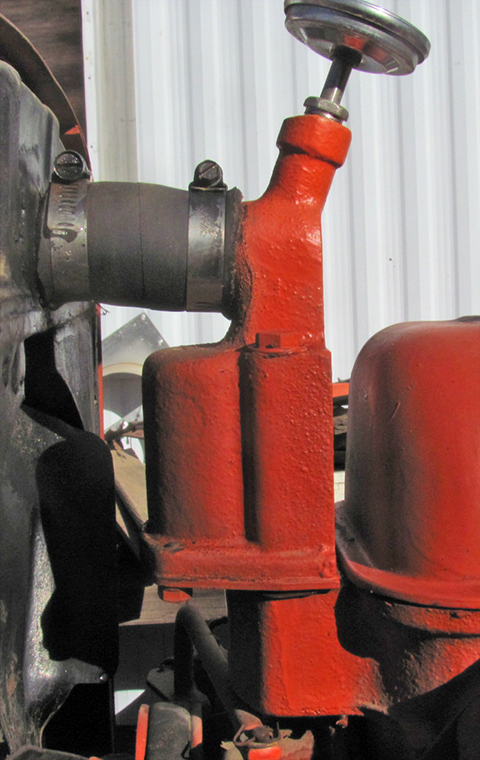

Posted By: theropod
Date Posted: 04 Dec 2017 at 3:54pm
OK, here is what is supposed to be the thermostat housing on my B. I have not seen one anywhere that matches mine. I don't see how a thermostat could fit in this at all. It would have to be placed inside the upper hose somehow, and I don't have a clue how that would work.

Posted By: CrestonM
Date Posted: 04 Dec 2017 at 4:00pm
I agree, that's totally unlike mine. Mine has a housing for a thermostat, but no thermostat installed. I could put one in, but I just use the shutters.

Posted By: drobCA
Date Posted: 04 Dec 2017 at 7:26pm
yeah, yeah these pictures are horrible.  will replace them them tomorrow with the hood off and in the light.  but meantime, here's how my 41 B arrived to me - same housing as Ranse's - and I am eager to see what his hood looks like.
sure hope not like mine - he must have used one of those old hook-type canopeners to cut the hole.

Posted By: Alberta Phil
Date Posted: 05 Dec 2017 at 10:42am
theropod, your '38 'B' never had a thermostat. That is the early style water manifold as they called it and those types never had a thermostat. They used shutters to control water temp. I have an early '39 'B' which has the same water manifold.
 After engine number 23815 a thermostat housing was fitted which is the type that has the spring  to hold the thermostat in place.
Posted By: drobCA
Date Posted: 05 Dec 2017 at 12:17pm
well, Phil identified theropod's housing and satisfied my curiosity. thanks!
here's a picture of my 1941 housing trying to give ranse an indication of how thick the original "bottom plate" was.
mine looks to be just a hair under 1/8" and is presumed to be factory.
Thanks Phil. That eases my mind.
Since I don’t have the shutters anymore, or anywhere to mount a temperature gauge, I am sort of up against it here. Even if I had the shutters there would be no way to know how hot/cool the engine is. My radiator is internally vented so my B was never meant to be pressurized. Those caps with a built in gauge have short little probes, and if the coolant evaporated it would quit working right.
I am tempted to drill out my tower/manifold thing and tap it for a sending unit and mount a gauge on the tool box where the crank handle stores. I bought a straight shank crank to replace my old one as it is absolutely wore out and it won’t fit on the mount point. That would be a perfect place for one.
This all sounds like a spring project, so time isn’t a problem.

I'm glad someone identified theropod's housing.
drobCA, thanks for your pics. I guess mine was correct after all. I need to order a spring and I think I can reuse the home made plate. Someone did kind of a crude job but it didn't leak so it should be ok. I can't imagine why someone cut a square hole in your hood. My sheet metal isn't perfectly straight anymore. If you look closely you can see the gauge is not dead center in the hole. This the only reason I can think of for making the hole larger.
Posted By: drobCA
Date Posted: 05 Dec 2017 at 10:16pm
the magic words are "it didn't leak", Ranse.
so likely it will work again.
I just wanted to let you see what "normal" looked like so you could come to your own conclusions.
I doubt even the correct police with magnifying glasses would notice unless you pointed it out.
meanwhile it's pretty and it runs.
enjoy your B!
