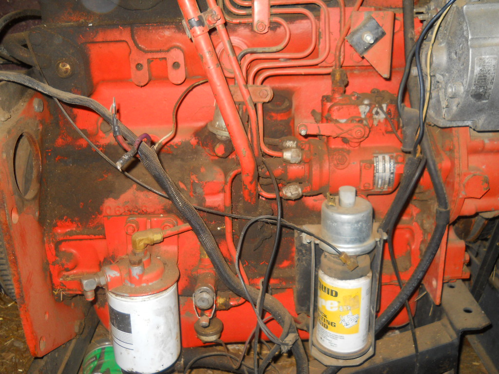

Posted By: lowell
Date Posted: 25 Jan 2016 at 8:15pm
couple pic one of my car and one of the engine
Posted By: HD6GTOM
Date Posted: 25 Jan 2016 at 8:34pm
That is a lot newer engine than I have delt with. Should be the heaver bottom end. I have attended the Good Guys car show in Des Moines, every now and then you see one with a diesel. Good luck, don't get discouraged and give up on it. Please post pictures of your progress.
