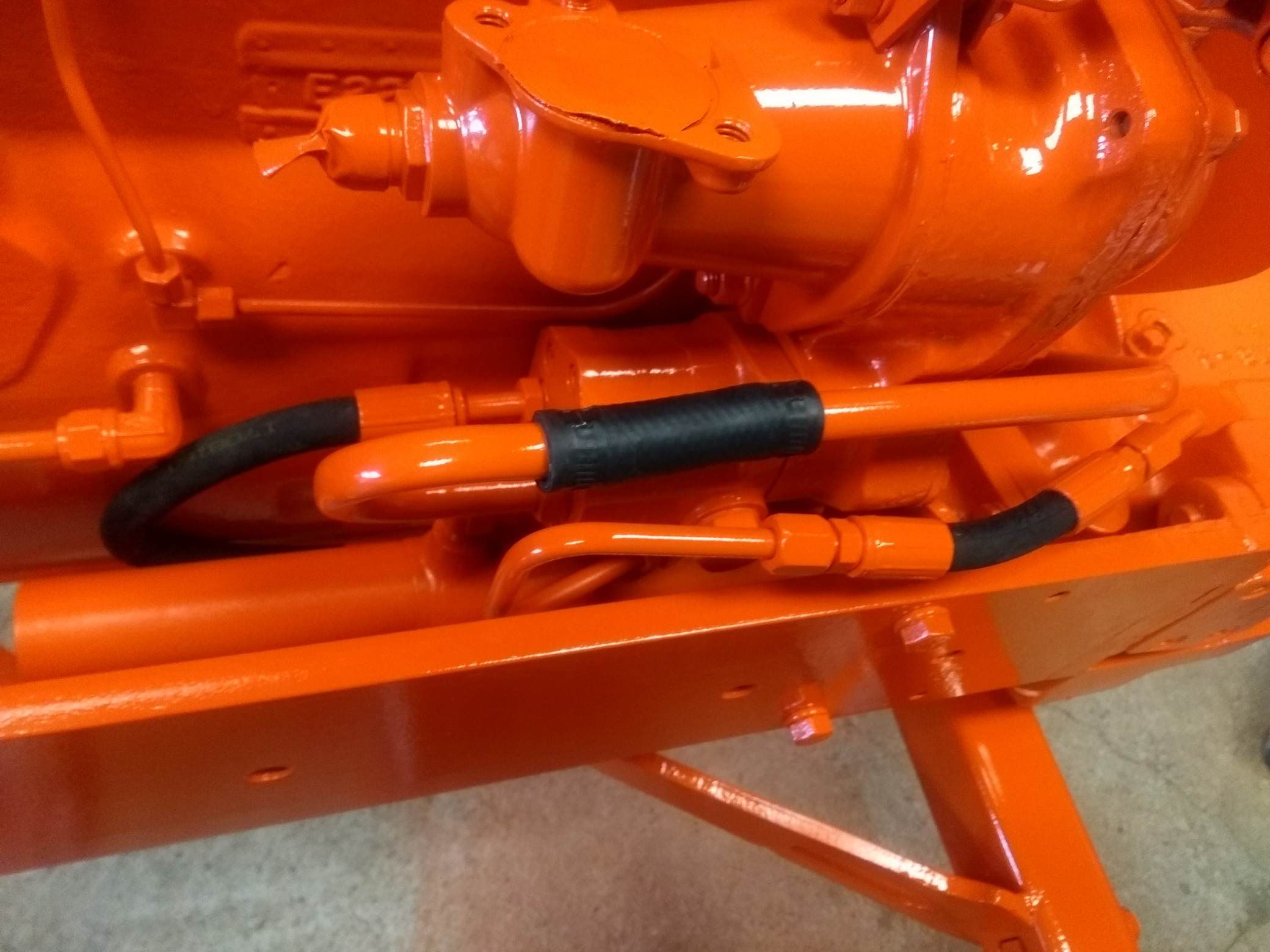

I took my 45 diesel power steering hose to my black smith, he cut the ends off both sides of the hose and welded them on a new crimp before he crimped it on a new hose.
Looks perfectly original plus it doesn’t leak anymore.
Talked to an Agco parts dealer and they wanted me to put adapters on and tried to charge me an arm and a leg for the set up.
