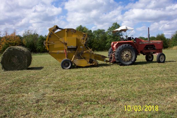

My XT and baler since 1988. Rolled up about 400 this year
