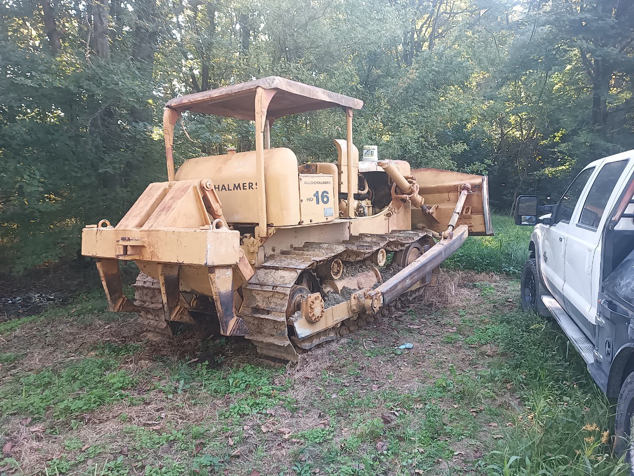

Greetings all. Who knew becoming a land developer would find me owning such a variety of heavy equipment but here I am again with my potential acquisition of an Allis Chalmers HD16DP-7748. I do not know for certain but I am going to put this around the 1967/68 vintage. It's certainly larger than my D6.
I went to check this bad boy out and it is in unbelievably great shape... everything works very well accept an issue with what I believe to be the transmission. The current owner explained that the unit would not move when he purchased it. Found the transmission dry... no fluid. They filled it up and that got it to moving. Over time it has retreated into a process of firing up the motor... than working the forward/reverse back and forth until the machine begins to move... initially it will move about 10 feet in both direction and then build up as you continue to cycle back and forth. Ultimately it will reach a point that it will move well for the day until such time you shut it down and let it sit. You then will have to repeat the process. I have ordered a complete set of manuals for it but do not have them yet. Thought I would look to see if there was an A-C old timer on here that could lend some pointers.
I have posted this info in other tractor sites and have others telling me to run... don't walk... away from this purchase.  Those that bother to explain why suggest parts are an issue.  I'm finding it hard to even walk away from this.  The unit is in very nice shape... all movements work very well accept the issue I spoke of above.  My primary purpose for purchasing is the monster rake on the back and a 4 way blade.  My current CAT D6 has neither and I am working a project that requires both.

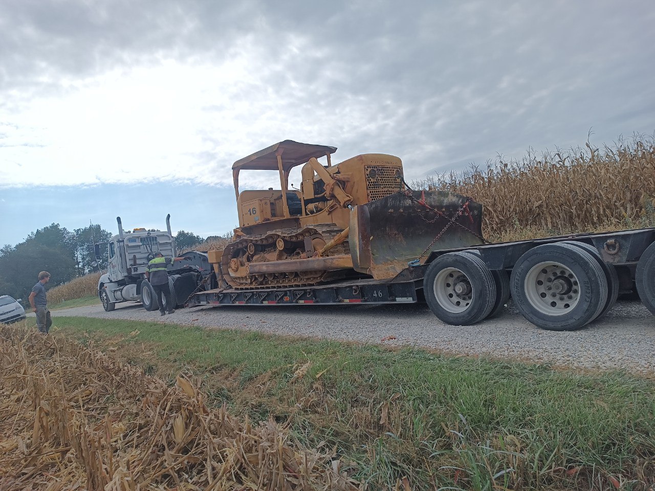

Post Options Post Options   Thanks (0) Thanks(0)   Quote hdokes Quote  Post ReplyReply Direct Link To This Post Posted: 15 Oct 2025 at 6:41pm

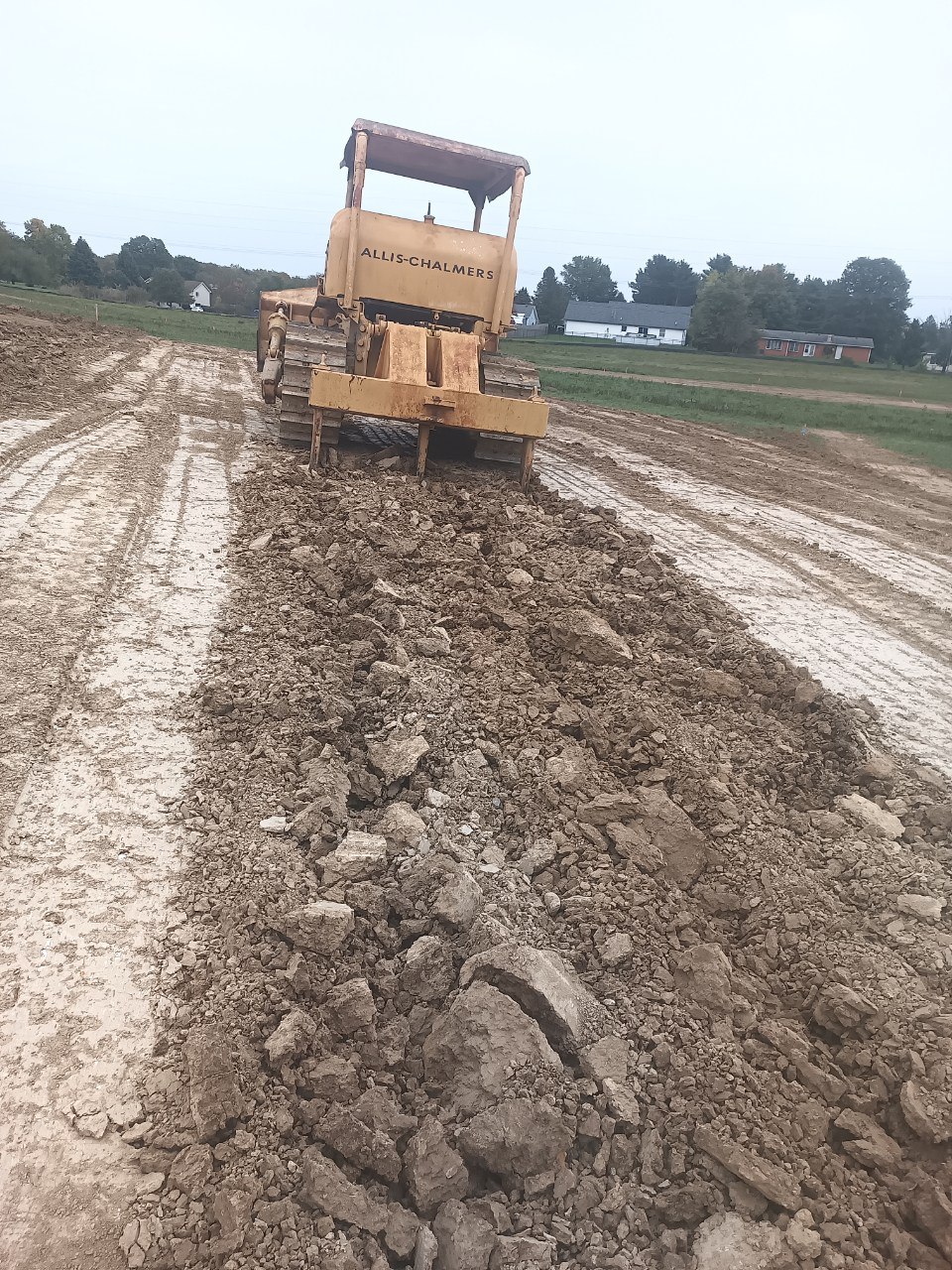

Got it home in one piece this evening and couldn't wait... had to give it a go in the rock hard clay. I love the results!!!

The ripper, while showing three tines, is actually capable of holding 5 tines.  I'm thinking this is just the ticket for a subdivision development we are building where we have decided to use lime mixed into the soil to stabilize the road bed.  I'm thinking this would/should be the first step after grading to prepare the soil for the lime.  Thoughts on where I might look for a couple of matching tines?

It's been suggested that I'd be better off leaving it with 3 tines.  The 'ol girl does have a bit of age on her and it's my understanding that the final drives have a week point in them of potentially stripping the splines.  Placing the additional tines on there may make her work a bit harder than she needs to be at this stage of her life.  Thus far I have found the 3 tines to be doing an excellent job and I have never seen the scraper fill up the bowl so quickly as it is following behind as I rip.  Expecting this to make a tremendous difference in moving all this soil.

Is a company here that adds stabilizing lime to soil on road projects, use a Rome Disc to cut it in as is faster than ripping.
