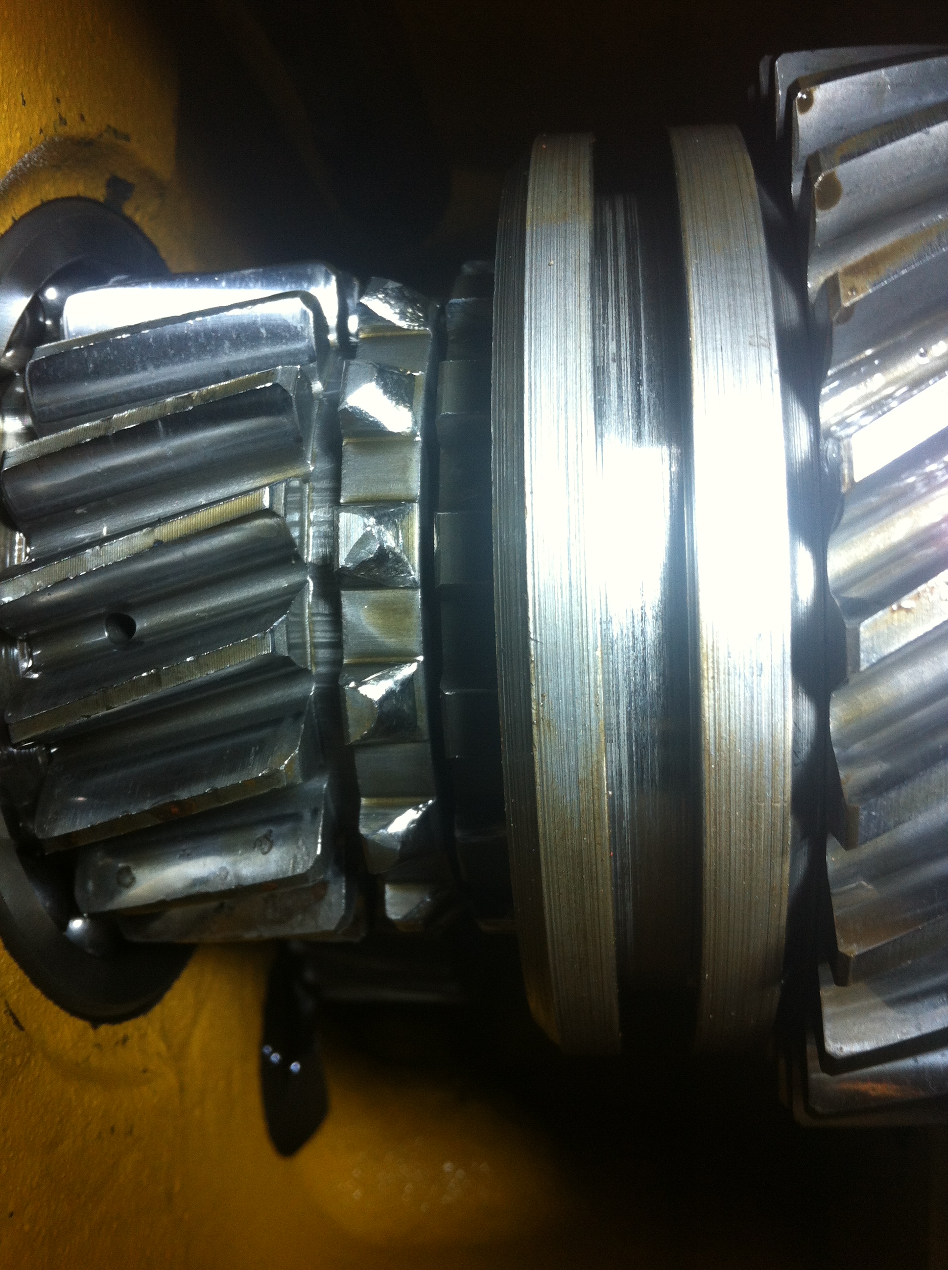

When  I bought this 190 tractor when you let the clutch out in 3rd or 4th gear it would pop into neutral it was so bad,  So I tore it  down and replaced input shaft (4th  gear) along with 3rd and sliding colar. Engagement teeth became arrow head  in shape and this caused gear poping.  DO NOT GRIND GEARS
Edited by Beirnesy - 24 Jan 2019 at 4:42pm
