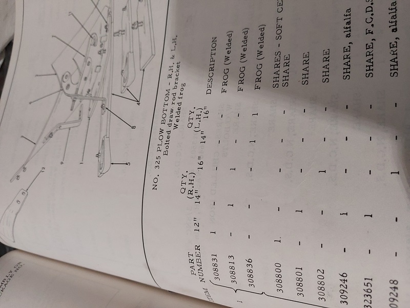

My son brought some plow shares over to me but I don't know what they fit. If someone  could tell me that would be great. Four different shares with these numbers, Starth.G.Co. 2X 14 AC, 308801-SC, 24-CRCS, 308804 Solid. Thanks so much in advance.

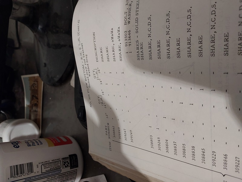

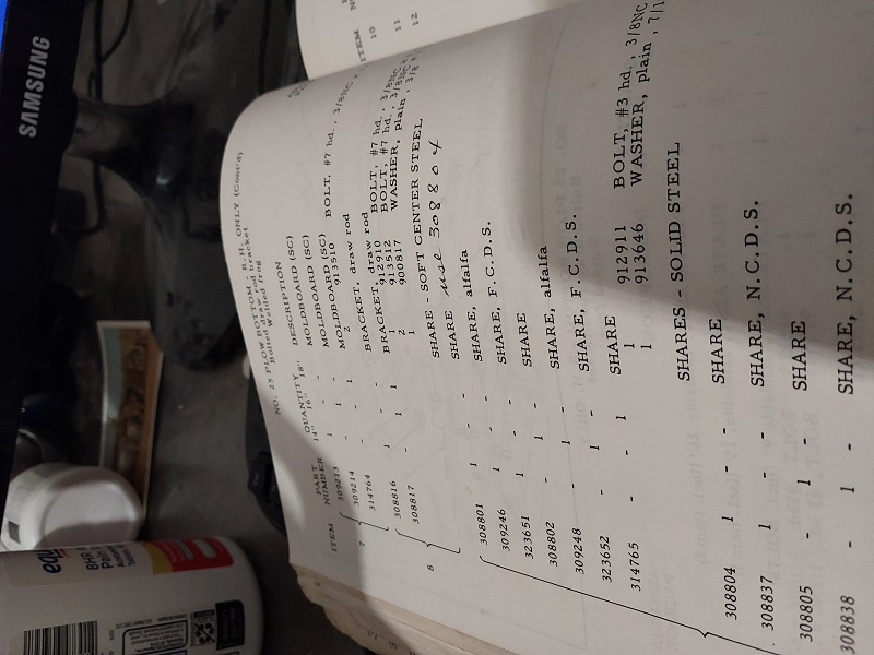

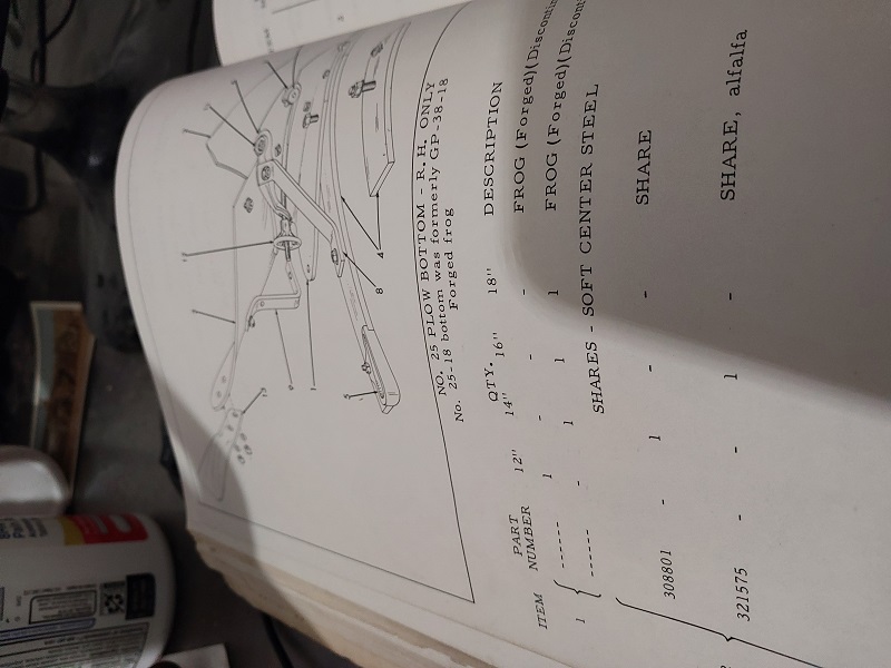

got this out of my plow parts book

Thanks Kenny. That tells me what 2 of the shares fit on.  My plow books all showed the old numbers and not the 6 digit numbers for the shares.
