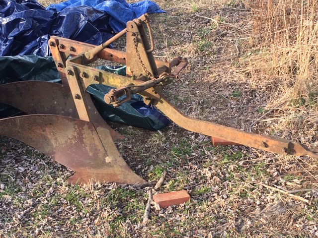

Hoping to restore this plow to functionality. Would like some help with model number.

Looks like a 72 to me, 70 series 2 bottom.  Post the distance between the bottoms.  If its 14", its a 72-14...Wink

That is a model 62 plow. A 72 will have cross bars that can expand or contract to 14" or 16". The 60 series plows DO NOT have that feature.  As the downward beams are angled and the width of cut is fixed, it can only be a 60 series.

Sorry Dave, but I've got to agree with Paul.  With no cross-bars for adjustment for width, it's a 62 versus a 72.

#62 for sure

I am looking for the part that hangs on the snap coupler . Not sure what it is called. It has the pin going through it . I also thought it might try to locate a couple of coulters. Thanks for responding to my post . This forum is very helpful. I have a D10 and will be having a lot of questions I'm sure.

I'm sure that I have the coulters for that plow. Don't think I have the top of the lift link that snaps into the lift latch.  I plan on coming to the GOTO in New York this June, if it doesn't get cancelled. I'm in Maryland, just below Gettysburg, Pa.
