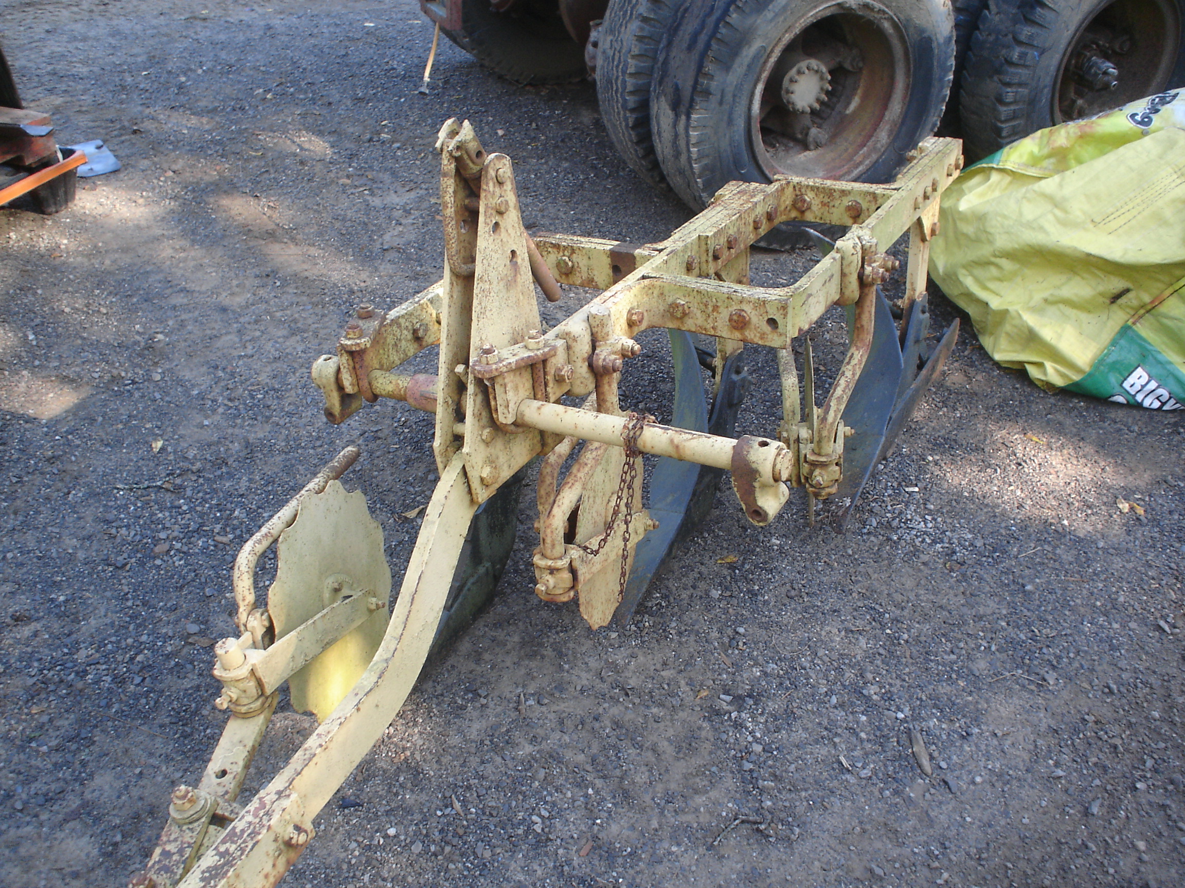

OK, Have a 3 furrow 'parts' plow( 1 of the poity things is busted...). Can someone please ID the model ? I'm thinking of tearing it apart and reworking it into a 2 furrow plow.
I need to make a beaming screw piece ,big nut from 2" trailer ball fits !
Thanks Jay

I can't tell but if the plow shank is not angled forward it should be a 50 series.
Dennis Anderson has a video on how to" I'D an Allis plow. I'll look for the link.....

Looks like it was a pin hitch plow with CA lift arm latches(missing).  is there a ring on the front or an arrow head?

It looks as though the width is adjustable.

here's another picture, internet cable was down,sigh. I borrowed the lift latch pieces,they're here 'somewhere'..... jay

Flip it over, if it has hook and bolt shares, its a 53...

The adjustable width makes it a 70 IIRC. There is a report on plows over on the  Farm Equipment Knowledge Base that includes maybe workable links to plow parts and bottom books to help identify the plow. Titled AC Plows Parts 101. It describes the plow frames details. Different eras of plows were fixed width frames, then adjustable width frames, then plow shanks anchored by screws, or later by spring loaded latches, so when a plow bottom snagged a big rock the effect on the plow was different.

Looks like that rare adjustable model 53. but the right angle rods are a mystery. I've been wrong before.

Looks likme someone put 50 series stub beams on a 70 series frame.

sigh... sounds likeI have a 'frankenplow'......
so more questions... I assume 53  means series 50, 3 furrow so I'd like to make it into a '52'.
What are the laying down 'L' shaped rods or bars for ?
I've had it for 10 years and thought it'd be nice to turn into a WORKING  plow....instead of a lawn ornament.
Jay

The adjustable width frame (as it appears to be) is 70 series design. The problem is everything else appears to be 50 series. Look at the pull tongue and the front coulter. That sure isn't 70 series !!

DrAllis is right on. 70 series frame and about everything else is 50 series. This does not mean that it will not work, you just have a very interesting plow. It will make a lot of people scratch their head in wonder!

That is EXACTLY like mine, 53-14, except for the right-angle rods - looks like maybe someone tried a DIY trash management solution.
