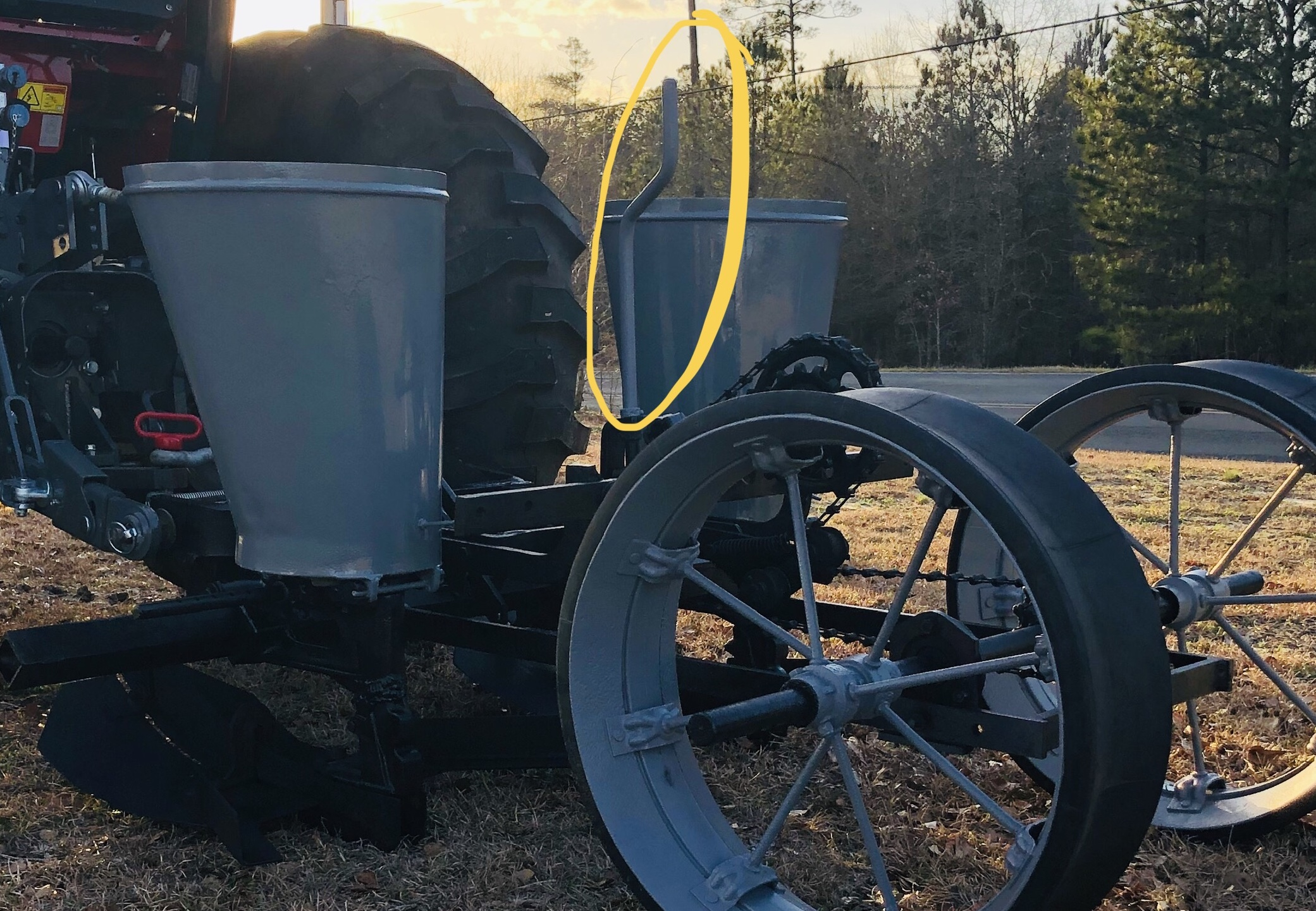

I have the skids thats Mounted onto and around the shoes to control depth, but needing to know where to adjust the lever that turns and raises and lowers the 2 wheels in the rear. I’m guessing this controls down pressure on the wheels.

Post Options Post Options   Thanks (0) Thanks(0)   Quote Garrett2006 Quote  Post ReplyReply Direct Link To This Post Posted: 08 May 2019 at 7:04am
I have uploaded & circles the part I’m talking about

Post Options Post Options   Thanks (0) Thanks(0)   Quote ac fleet Quote  Post ReplyReply Direct Link To This Post Posted: 08 May 2019 at 8:50am
Don't see any circles or a part, ---I only see a rear tractor tire and a can lookin thing.
Points: 8684
Post Options Post Options   Thanks (0) Thanks(0)   Quote SteveM C/IL Quote  Post ReplyReply Direct Link To This Post Posted: 08 May 2019 at 8:58am
move the pic side to side....

Post Options Post Options   Thanks (0) Thanks(0)   Quote Don(MO) Quote  Post ReplyReply Direct Link To This Post Posted: 08 May 2019 at 9:23am
I have seen drill planters changed to three point hitch have trouble holding the right depth,
if you can hold the three point at the same depth after lowering it down every you lower it and yes that lever is how you can set the 1 1/2"/2" on the planter.
