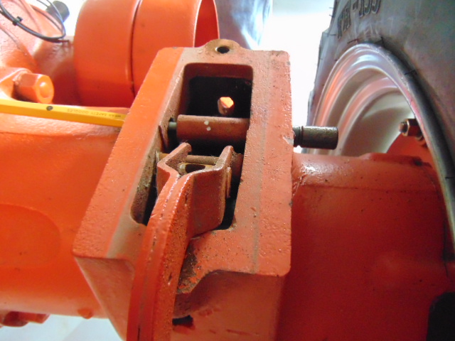

How do you guy get the pins that hold one end of the brake band out? the pins with the spring clip

Drive them out through the two holes in the casting on side of the brake housing.

Sorry, I forgot about the C clip that retains the brake band pin in the housing.  The C clips can be pulled out through the large opening in the top of the brake housing.  This has to be done before driving the brake band pins out.

Wasn't too bad, need you a large persuasion device and a good quality drift.
