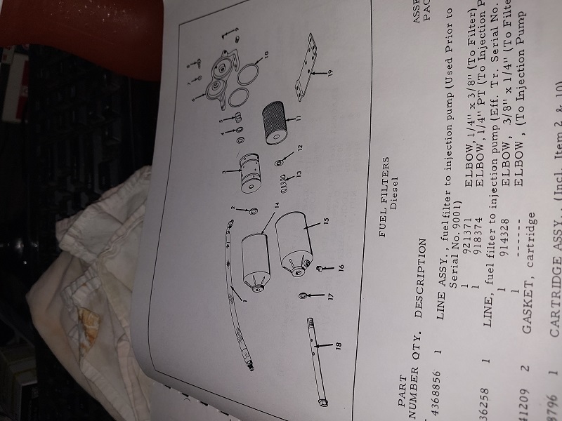

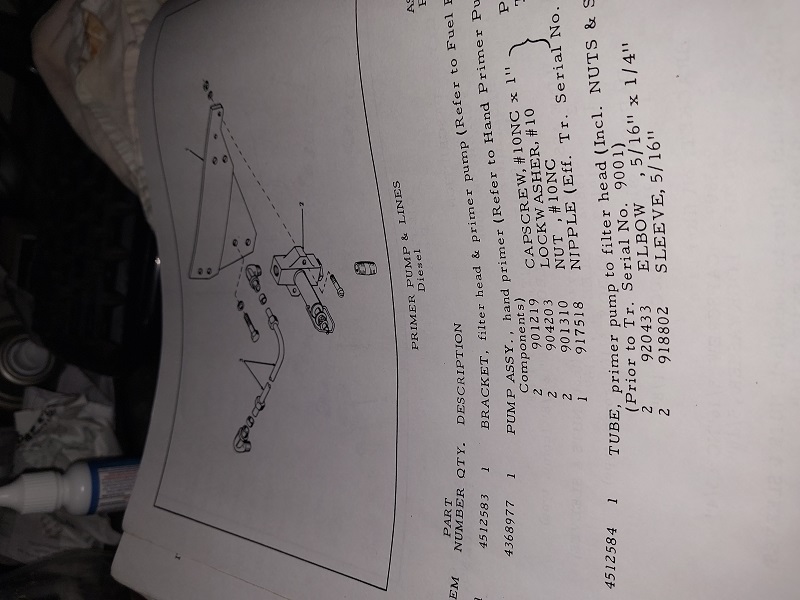

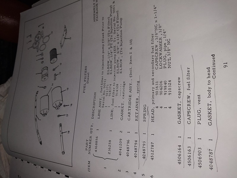

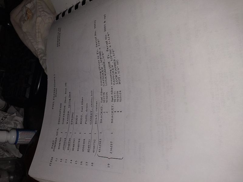

Post Options Post Options   Thanks (0) Thanks(0)   Quote Kenny L. Quote  Post ReplyReply Direct Link To This Post Posted: 12 hours 4 minutes ago at 6:06pm
Here some pictures out of my D15 parts books which cover both I @ II.

Post Options Post Options   Thanks (0) Thanks(0)   Quote DSeries4 Quote  Post ReplyReply Direct Link To This Post Posted: 2 hours 41 minutes ago at 3:29am
Thanks Kenny. Once again, that's for a series 1.
I would prefer a picture of the correct set up on a Series 2 tractor. As mentioned earlier, none of the Allis publications have been useful in this case
