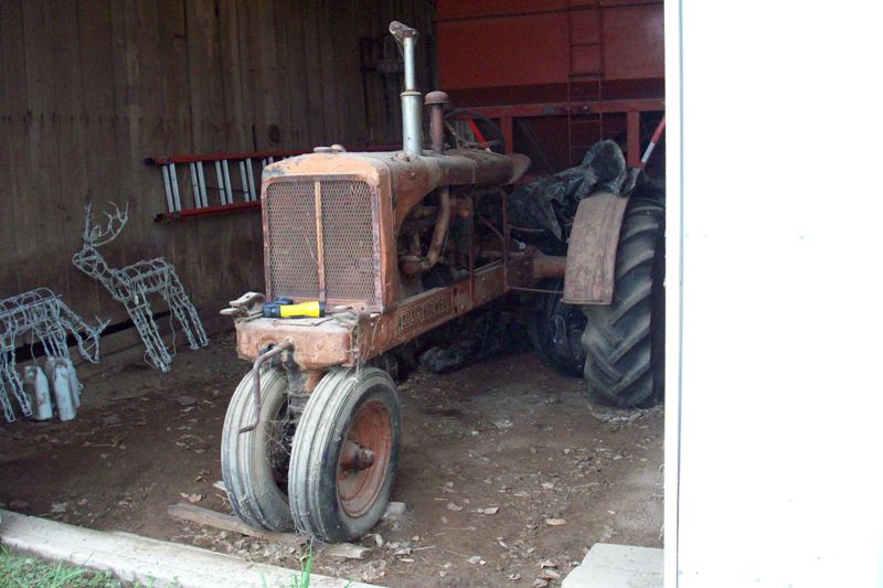

This is also my first try with modern Urethane paint.  Nason brand.    I have got by with Van Slyke alkyd and hardener in the past.   I am going to practice on some small tractor rims that need some John Deere yellow first nad work out the bugs a bit.  The lady at paint store actually knew what PO #1 was and was quite helpful.
I have had the tractor for probably 10 years now. It had sit inside for almost 20 years as I understand before I got it (you can see cobwebs). It always started easy but wasn't much to look at...

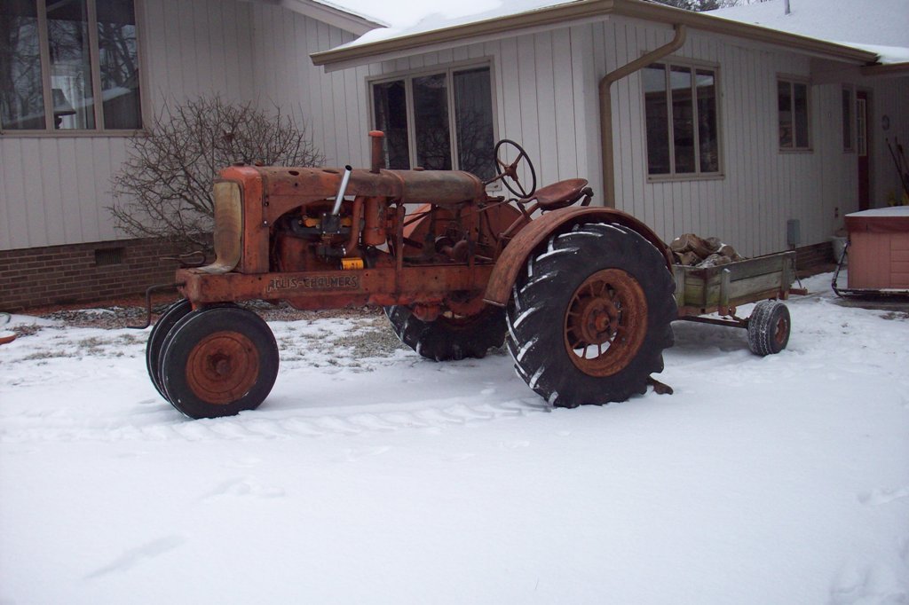

I always tell folks about the cold winter day when it was the only tractor that would start so I used it to move some firewood up to the porch.

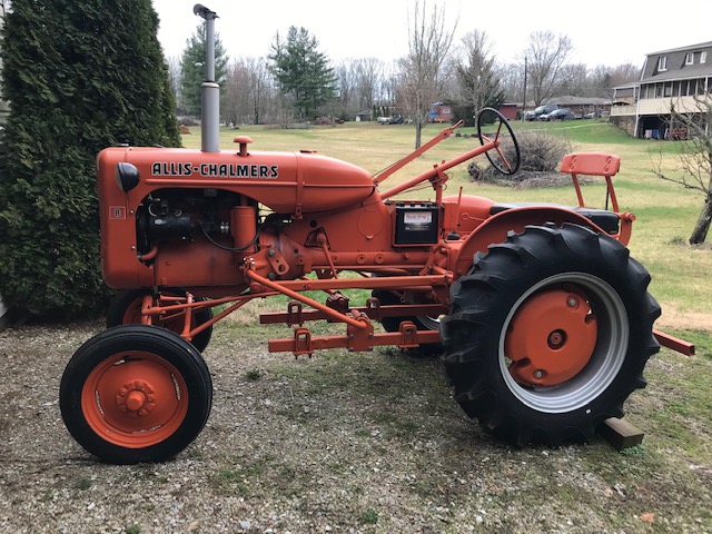

Some pics of the B I did about 2008.  That is Van Sickle PO #1 with hardener.   Gasoline is hard on it.   Sun is too but I keep it inside most of the time.

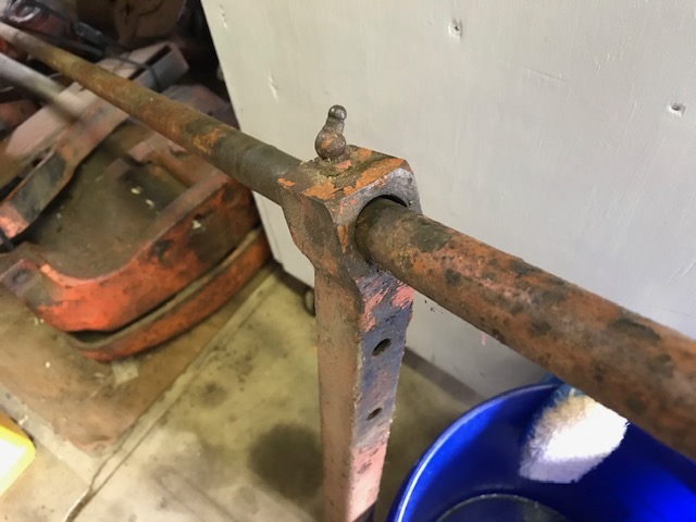

Here are some pics of items that are in progress.   Shaft and the old guides are well worn.  It ran good but got pretty squirrely in road gear.

Good looking B! Now is for sure the time to replace the seal on the clutch shaft. Any time you can improve the worn clearances in shafts and joints you will be happier with the finished tractor. You dont notice it much when they are tight and work correct. but you sure notice it when they are all sloppy and loosey goosey.
