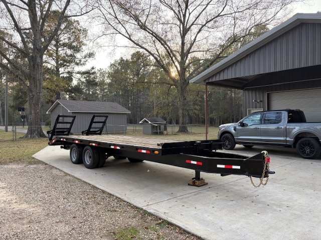

Post Options Post Options   Thanks (0) Thanks(0)   Quote AveryD12 Quote  Post ReplyReply Direct Link To This Post Posted: 07 Jan 2026 at 5:59pm
Hope the picture loads.
Thought you might want to see the finished paint job. Not great but a lot better.
Thanks for all the advice
Avery

Post Options Post Options   Thanks (0) Thanks(0)   Quote FloydKS Quote  Post ReplyReply Direct Link To This Post Posted: 07 Jan 2026 at 6:21pm
looking good... worth the time it took to do the job.

Post Options Post Options   Thanks (0) Thanks(0)   Quote 55allis Quote  Post ReplyReply Direct Link To This Post Posted: 07 Jan 2026 at 9:17pm
Looks like a new one!!

Post Options Post Options   Thanks (0) Thanks(0)   Quote jaybmiller Quote  Post ReplyReply Direct Link To This Post Posted: 08 Jan 2026 at 6:11am
yessh... I was thinking 4by8 'trailer', WOW that thing is HUGE !!! and PRETTY !!
Can it can a 'B' though !??

Post Options Post Options   Thanks (0) Thanks(0)   Quote AveryD12 Quote  Post ReplyReply Direct Link To This Post Posted: 08 Jan 2026 at 7:45am
Thanks everyone. I have owned it about 12 years. Bought it with the intention of doing “this”. Just now getting around to it. I might tend to procrastinate a little 😂. New paint, new lights, new reflective tape & new safety chains. Deck is only a few years old. Should be good for several more years now.
