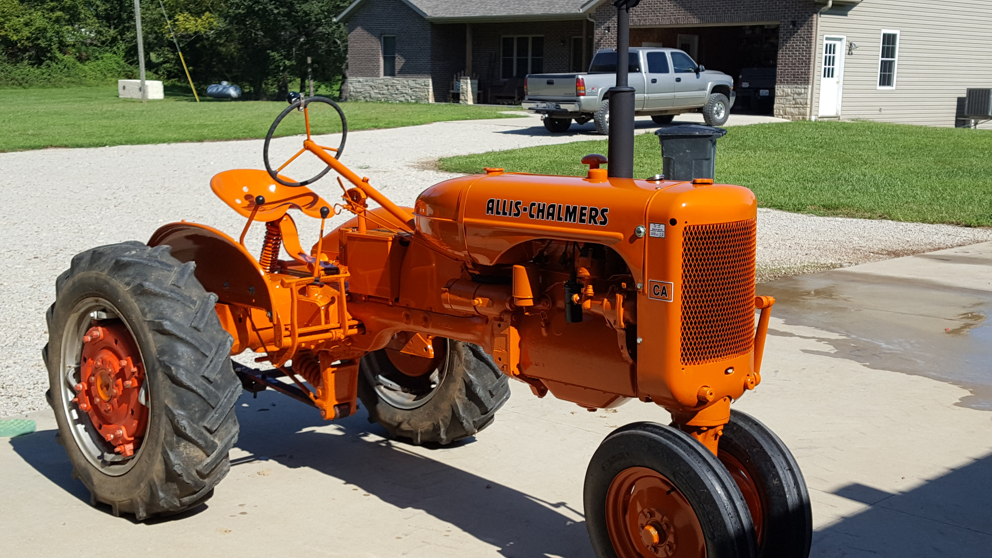

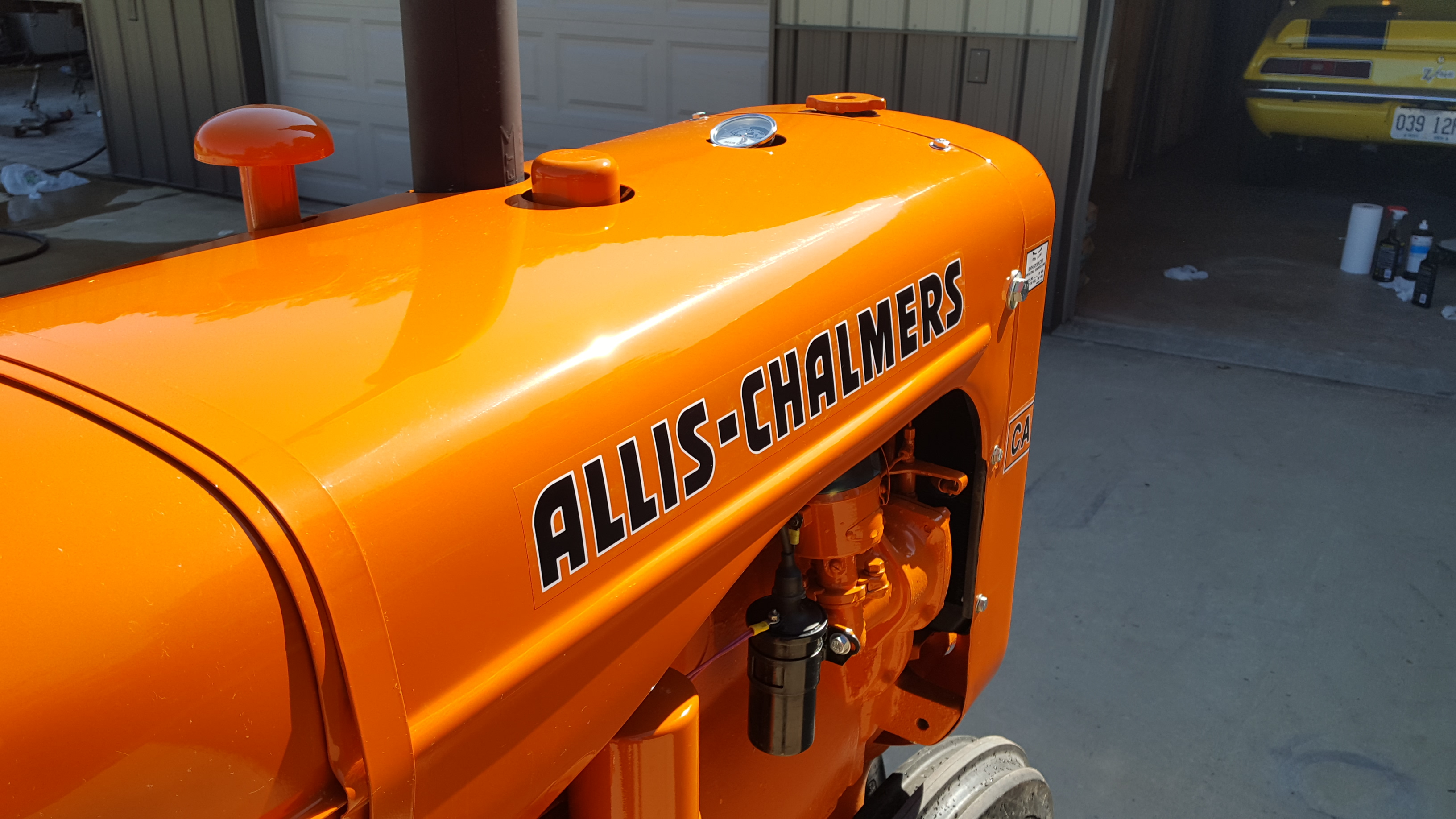

I got around to painting my 52 ca last week. I did some research on Persian orange #1 and looked at the dupont spectra master ys073 and ys074 that some have used. I found that summit racing has an orange that in my opinion is as close to po 1 as those colors are. I bought the gallon of paint activator and reducer for $111 to my door. This is for single stage urethane. I am not advertising for summit, I just thought it may help some people save some money. My dupont jobber wanted $275 for a gallon of paint alone.

The CA looks good to me. load her up and come to the GOTO at Boonville next week and we can all look her over.

Looks GREAT man! That color is darn close to the color of my IB. Great job!

Very nice paint job.  How did you prep the tractor?  Just curious.

I oven cleaner and pressure washed the cast stuff a couple times to get the grease off. Then I used aircraft stripper to remove the paint off the cast. I epoxy primed and then painted all the cast. On the tins I stripped with brush on stripper. Sanded and epoxy primed polyester primed then finished with urethane primer and paint.

Boy that really looks nice! You did a great job on the color match and the details!

Can you tell us the Summit part numbers for the paint?

  Hey Racin,,,that right there is a GREAT price for a gallon of Urethane and,,delivered even,,,,I'm thinkin thats even lower than TSC's price on their paint and their's isn't Urethane,,,,Clap
  You did good on the paintin and got good flow-out,,,,ClapClap

Sum-up306 is the part number. The color chart is only about $3 to your door. It's the standard urethane single stage. Not the low voc. I would recommend getting that in hand and deciding if the color works for you since it's not marketed as po #1.
