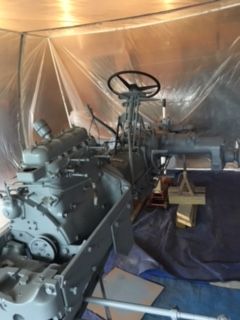

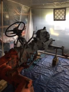

Paint Booth:
Primer started
Primer complete

I'm impressed with your paint booth!!

Post Options Post Options   Thanks (0) Thanks(0)   Quote HVFDFIREFIGHTER Quote  Post ReplyReply Direct Link To This Post Posted: 12 Aug 2016 at 1:55pm
PVC pipe and 2mil plastic. 13'x10'x7' 8 3/4" 3 ways, 4 couplings, 12 10' 3/4" Pvc pipe, 20" box Fan on one end and furnace filter on other. Seems to work. Having trouble holding plastic to floor. Might have to wrap in 2x4. Sat 2x4 on top of plastic but it keeps pulling out. I'm guessing I should wait 24 hours before top coat?

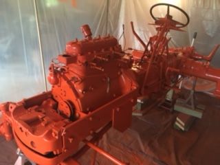

Primer was dry this morning.  Lightly sanded and put first color coat on.  Will check tomorrow ans see if it is ready for a second coat.  I noticed a lot of orange paint on the floor and on the corners of the walls near the floor.  Kinda hard to spray the under side of the tractor.  The angle of the gun just does not make it easy.  I like the results so far.

Post Options Post Options   Thanks (0) Thanks(0)   Quote Play Farmer Quote  Post ReplyReply Direct Link To This Post Posted: 14 Aug 2016 at 6:21am
Looks good! I like your booth too.
Two coats should be fine, as long as they were 2 decent coats. I usually do a light duster coat at first, followed by 2-3 decent coats. Knowing when to walk away is an art.
