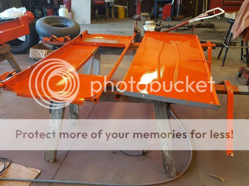

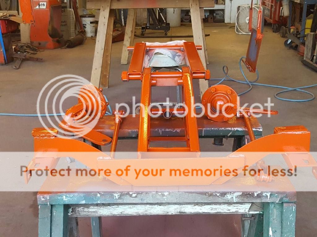

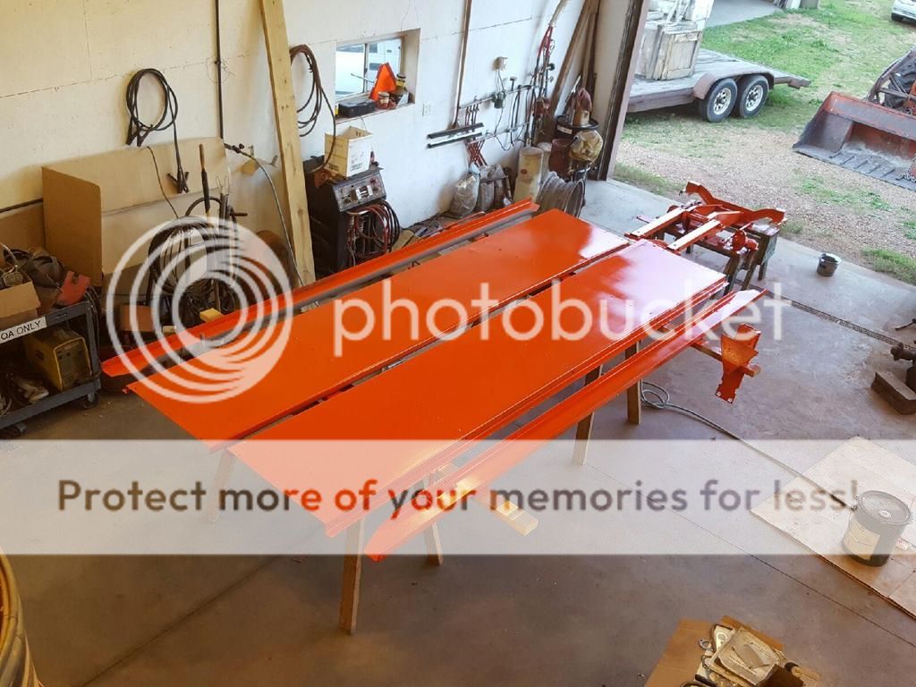

I am painting an allis wagon gear and a barge box, the primer went on great, but now I have put on the first coat of paint, everything sprayed great, layed down great, But it has been 3 days now and it is not dry. I have now put it outside in the sun but it does not seem to help.
I used a Polyurethane enamel paint and thinned it out with xylol, Did I do something wrong?   It has been very humid here lately I am thinking that isn't helping.
I still have to do more painting, I am wondering what I can add to help speed up the drying time? Maybe putting a hardener in with it? Or find a faster drying reducer?

Enamel takes a long time to cure/dry. Hardner will help. My 190xtd was repainted I'm guessing in the 80's. When I was prepping the sheet metal the paint under the decals was still soft to the point I could almost scrape the paint off with a putty knife.
Don't know if it pertains to enamel paint or not but automotive paint can dry in the air before it even hits the surface your painting if you use a reducer that's too fast. Plus the reducer has to be compatible with the paint your using.
You might just have to use hardner and be patient. I used enamel and hardner for my tractor and you could handle the parts the next day if you were gentle. I would say it was cured/dry in about 2 weeks to a month, roughly.

With urethane enamel you have to use a harder. Without it I have no idea how long it will take to dry or how durable it will be when you're done. This one sounds like a big Oops.
Just out of curiosity, what did the directions say?

  Hey Matt,,,as a rule,,,,,Polyurethane paints are a two component system, consisting of the topcoat AND a hardner that is required for the paint to harden. I don't think your paint without the hardner is going to set up enough to give you any kind of longivity, and prolly will have to be removed and start over. I know that ain't what you wanted to hear,,,,,

Matt; PF and Joe are right you must use hardner with that type of paint otherwise you have nothing. I am no expert on painting so when a project comes up I go to the paint store and explain what I am painting and go by there recommendations. On tractors there is also a third step in the process and that is to use a sealer on top of the primer before finish coat. When all goes right you should be able to handle painted items in a couple of hours. Not sure what you should do now.     Mark

Well, yeah Live and learn right...
Here is the short story of the paint.. I got 5 gallons of it for free... Just trying to use it.
As far as directions there is nothing on the pail. I talked to a friend of mine that owns a body shop and he was not too familiar with it but said it will dry but might take 5-7 days.   The next batch i am going to get some hardener and try that.
It has been really humid here lately so I am guessing that might effect it as well.

It sure looks good in the pictures.
Can you post of picture of the can, or let us know what brand of paint it is, or any other information you can post. Maybe someone can offer specific information on what you're spraying.
