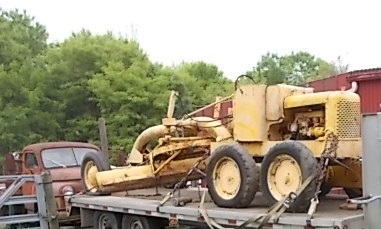

Back a few months ago our club VP found this grader and got together with our President to hold an emergency executive meeting to make the purchase, for next to nothing. I was asked to get it running and operational. Due to having three pulls early this year, I only found time to got bring it back to my place to get it going.  It is and early model with the 201 WD engine. The motor turns over, it needs to be re-wired, re-tired and have all the hydraulic hosed replace. Then it should be good to go.

   Hi.   The 'D' grader will be a perfect fit for your track. I saw a YT. video of a D grader doing the ground work for an indoor pull event in Texas (I think).
   The 201 engine was used until 1953.
   What is your serial number?
   Does it have the auxiliary transmission which can drop the road speed by 66 percent while maintaining your RPM's?
   I noticed, when we were at the Flywheelers show in FL. this past Feb., that Jack Gustafson's D grader was being repaired for the Flywheelers needs. Its been there for a lot of years.
   Enjoy your D grader. I am sure it will do a great job.
   Can you please send more pictures of it?
   Ross.
