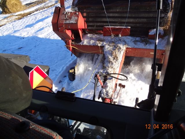

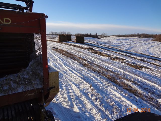

I thought someone might like to see it is possible to winter bale with the right baler. Its a NH 852, 30+ years old, working in -5 to -20 C or a bit above and below 0 F. The bales are very heavy with the snow, so I'm making them smaller - approx. 4 1/2 feet dia.   The swaths were snowed on twice and melted out in Oct and in Nov it snowed again and stayed.   I had to wait for it get cold enough so the ground and swaths froze. Otherwise, it would stick inside the baler and not turn.
Anyone else with experience like this?

I'm baling oats and using it to bed cows.   A bale processor chops and spreads the bales but you can see a cloud of white mixed in as it blows it out the machine.

Glad I seen a picture of this! Never would have believed it. Do what you need to do and should make some good bedding.
Thanks for taking the pictures. Look like pretty solid bales too.

we have baled in the snow before also. looks like that chain baler works better than a belt baler in the snow.

I understand now Ron , sorry to hear that ! Youve got a good baler for it those old NH are tough !!

Probably want to give the baler a good looking over afterward.I know they always said working snow with a crawler would eat up the undercarriage.

I was wondering if you could take the baler through a car wash or a steam cleaner when you are done to try and get some of that snow and ice out of it. That is amazing I have never seem that but my grandfather talked about a year he square bales some hay like that. He said they only baled enough to feed out each day to some young stock said the feed wasn't much good but they picked it over and got by. Would have lost the cows otherwise for lack or feed.
