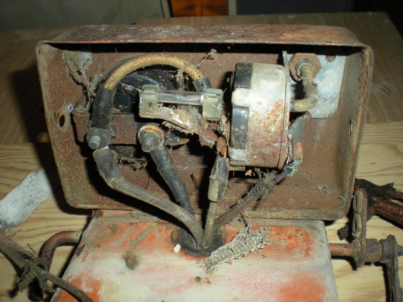

here is a couple of the switch more detail needed yet to the exposed knob, and new fuse but ready to go otherwise.
Edited by Redwood - 18 Jan 2012 at 6:48pm
