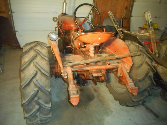

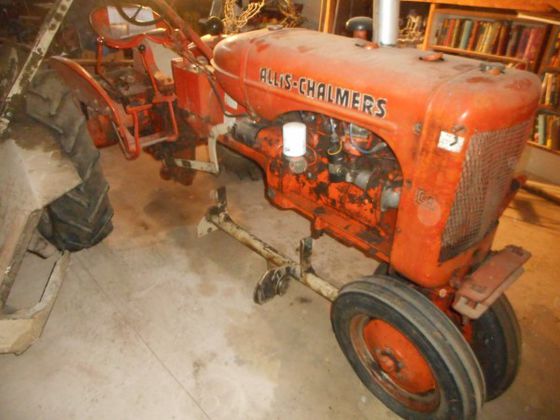

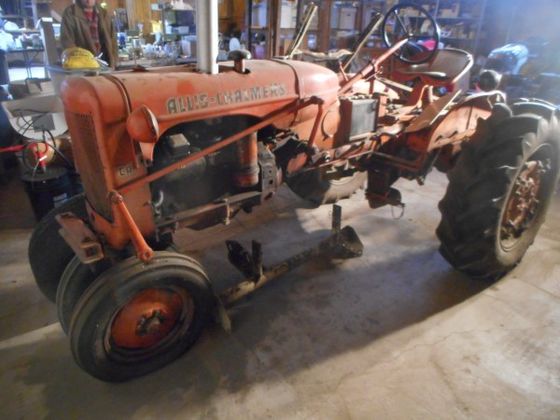

I'm looking for a smallish tractor and this one is available at an auction this weekend.  Primary use would be mowing & potentially towing logs.  I'm sadly lacking in background knowledge on Allis equipment.  The item in question is described as follows:
1953 Allis Chalmers CA (SN: CA255290 gas, narrow front tractor, garage stored for 10 years, non-running, needs battery, electric start, tires are Good, Live Power ("bale clutch"), hydraulic lift.
How does it look?  What should I be looking for as danger signs of a money pit?
What would should I pay if I'm going to get it functional for use?
What would you pay if you were going to flip it?
What else should I be thinking about that I haven't brought up?
Thank-you.

Looks like the front drag link is disconnected.??
IF you find a crank and can turn it over......the engine might be locked up.  If it turns easily, it will run with little problem!
You'd want to check to see if it is stuck, and also so you don't bend any push rods.
Looks like the drawbar is sitting on the rear, but the cradle is missing?
It has the lift arm latches......most are missing and getting harder to find.
Looks like it had/has a belly mower on it. Some of the pieces are laying there.  That would be nice!!

Was probably a worker it it's day.  The front end appears to have the cultivator mounting bracket.  Also, has supports on either side of the engine that could either be cultivator supports or for a loader.  The bracket lying on the ground is a Woods mower mounting bracket.  The mower can be seen to the right of the tractor in the third picture.
I've got a 1952 CA and they are a good tractor.  Can't tell you how much to bid on this one though.

As you know I am a real fan of the CA.  It is a peppy, great plowing, easy to handle tractor. That said it has been sitting under cover for 10 years.  Does the engine turn over?  If not forget it.
I would look at the oil.  Is it clean and filled.  Any leaks around the tractor.  To me when trading in a CA we always looked at the hand clutch.  It is operational.  If not MONEY
How about the transmission?  Slipping out of third gear?  MONEY
You won't get any answers on these questions till you buy it.  Therefore, you have to lower your buying price.  Too many unknowns.
I have to agree with $ 800 even less.
Nice looking tractor though.  It shows it has been kept inside.

Tractor ended up going for $900, not running with declared carburetor problems.  Was purchased by Granddaughter of owner.  I talked to her afterwards and she told me had intended to buy the tractor at pretty much any price.
