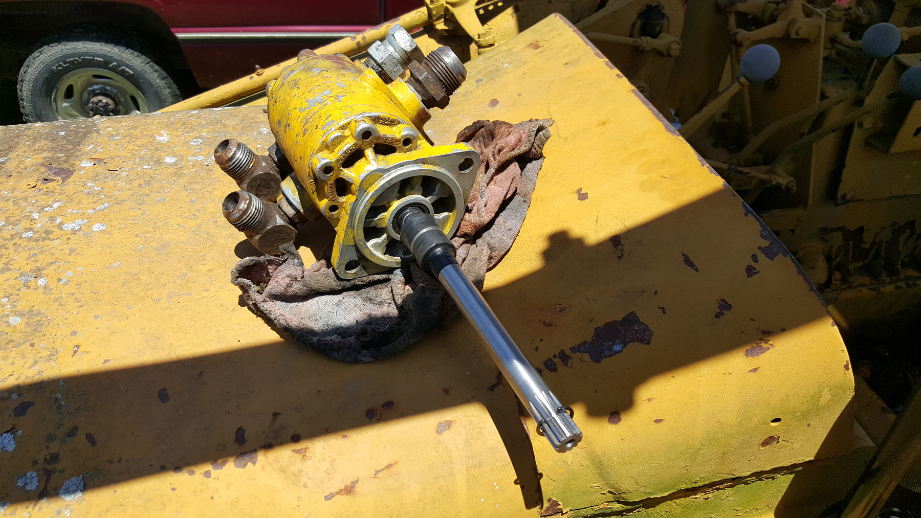

Of course, I need a new part.
So I've posted before in my quest to find a new shaft and coupler for the hydraulic pump.
I finally got them fabricated by a shop in Tulsa for around $250.

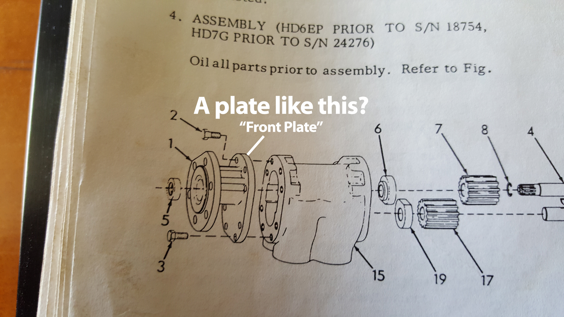

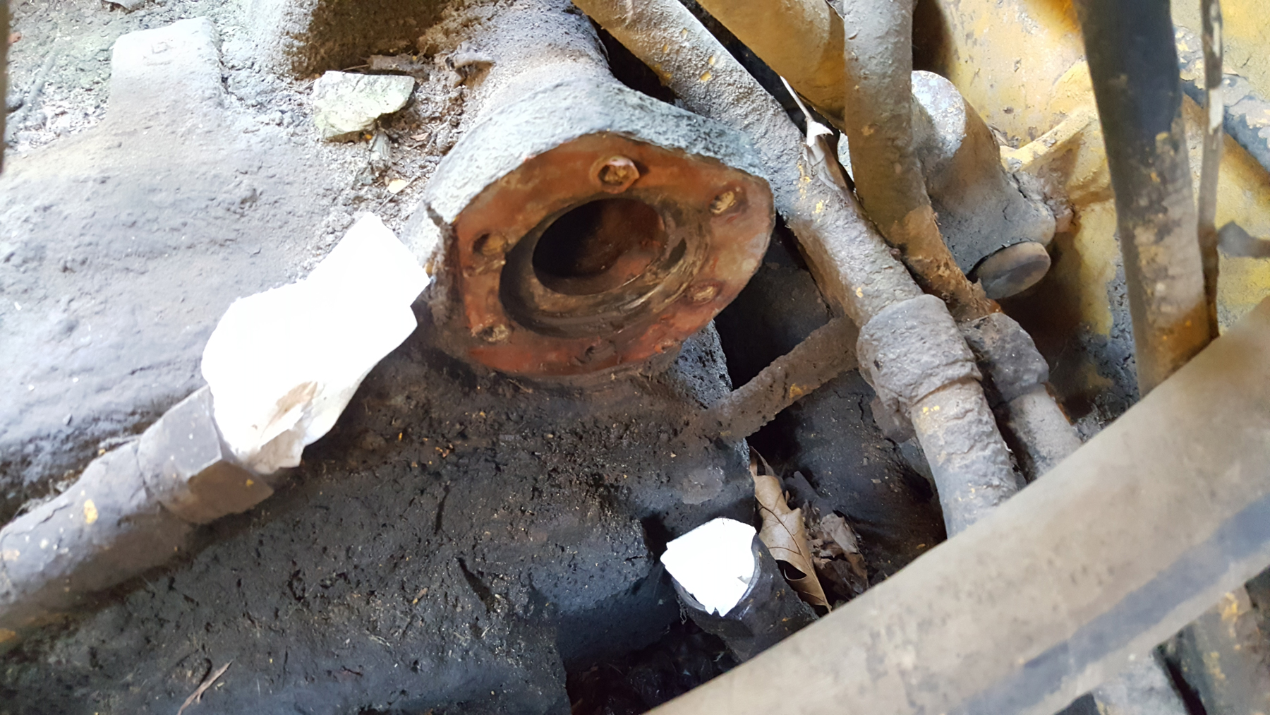

So we tried to put in the new pump and that's when I figured out that something was missing.
It looks like a front plate is GONE that the pump bolts into. I have the 6 small bolts
for the missing front plate and the two bolts for the pump...but I NEED THAT PLATE!
So that is where you come in.  Where can I go to find this plate?  Who can I call?
PICS BELOW

Your parts picture shows the first type oil pump.
Your pump is the second type pump for tractors after 24276
You need adapter 70650184
Hector has the adapter (spacer)
