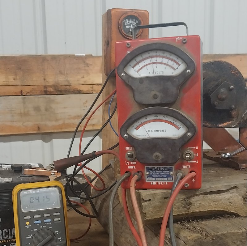

When you are working on vintage machinery, it adds to the fun when you have vintage test equipment with which to do the testing.
This SUN VAT-60 automotive meter was in my late Father-in-law's shop when it was purchased from the long-time proprietor, Chas. Wallace of Careywood, Idaho. The ammeter was non-functional but the voltmeter still worked fine. I opened it up and and found the ammeter switch was bad which turned out to be an easy fix.
A bit of google searching revealed some newer versions of the VAT-60 but they have more modern digital readouts rather than the old analog units on this one.
Just for grins I decided to test the SUN meter against my Fluke 88, so I set it up checking the one-wire generator output with the Allis-Chalmers meter, the SUN meter, and the Fluke meter all in series so as to compare the readings simultaneously.
The Allis-Chalmers meter was a bit optimistic at ~7 Amps, The SUN meter read ~4.5 Amps, and the Fluke reads right at 4.15 Amps.
Not bad for test equipment that hasn't been used for more than 60 years. Smile

interesting... got any idea of the DATE of the SUN ?
I worked at a Power Plant that was built in 1947 and lots of meters looked similar to that..
