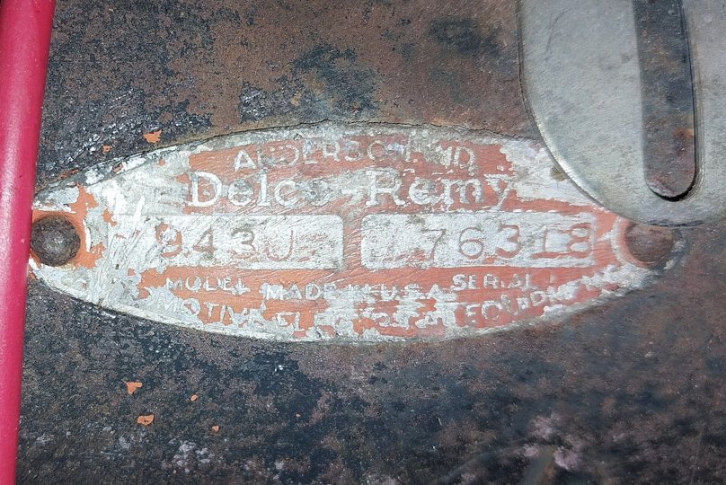

I have several old generators (thanks ORBill) that I am finally getting around to testing. This unit is a third-brush type and has no provisions whatsoever for controlling the field current; a quick google search for the part number 943U shows that it is for a 1931-34 Studebaker. Some further searching led me to a Studebaker forum where I found schematics that clearly show this generator having only one wire leading from the armature to the cutout relay.

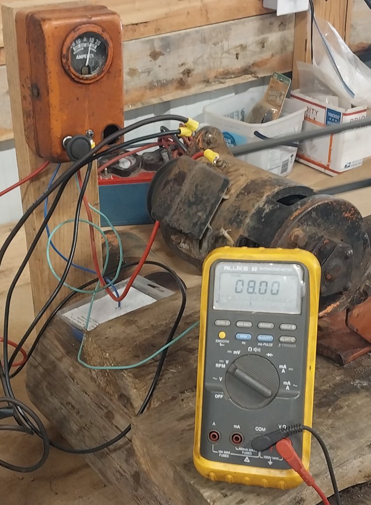

8 Volts at ~8 amps Cool

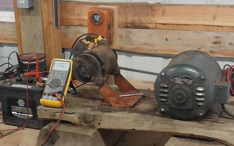

My high tech generator test bench

Reckon I ain't never heerd'a sech neither Big smile But thar 'tis, right at the bottom of the diagram. The third brush picks off the field current from the armature, and the circuit is completed inside the generator by being grounded through the thermostat gizmo.
Whereas our familiar Allis-Chalmers charging systems give us the choice of manually selecting a high charge of ~10 Amps or a low charge rate of ~3 Amps, this unit simply provides a fixed charging rate of ~8 Amps depending on where the third brush is adjusted. The only other control is the thermostat which I presume to break the field circuit if it gets too hot.
