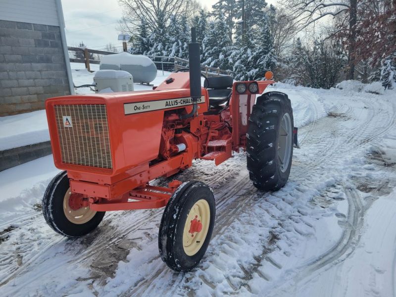

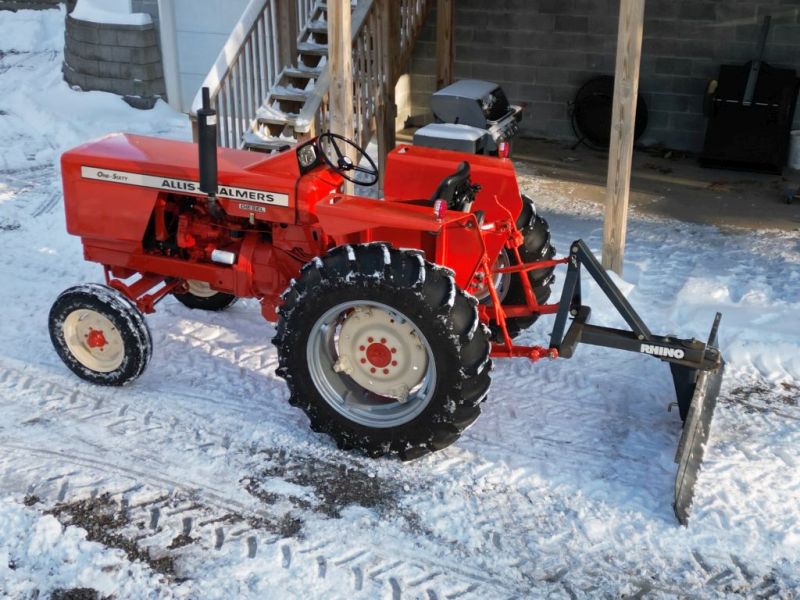

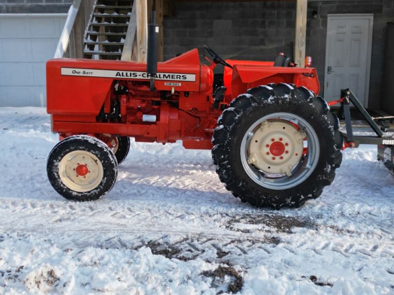

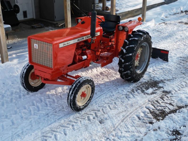

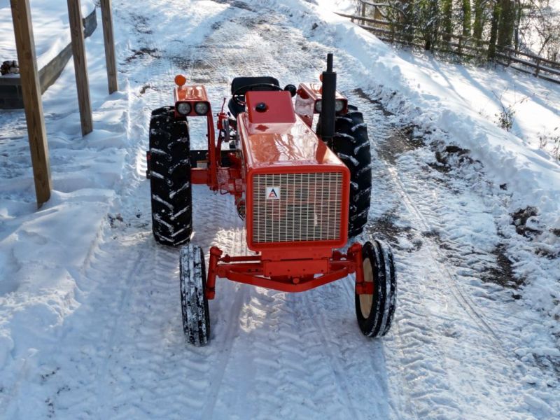

Some pictures I posted to FB following a snow storm we had in January.  The tractor tends to draw some attention at the tractor shows.

Wow, really nice job. Beautiful One-Sixty. First time I’ve seen the double step, it is a high step without it. Nice option to have. Thanks for the info I will give them a call.
