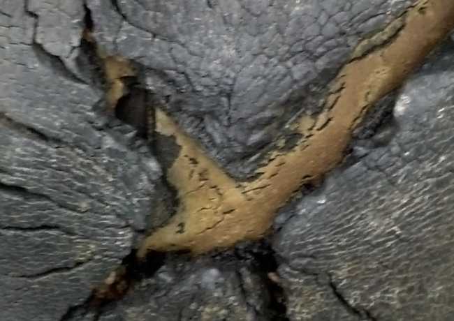

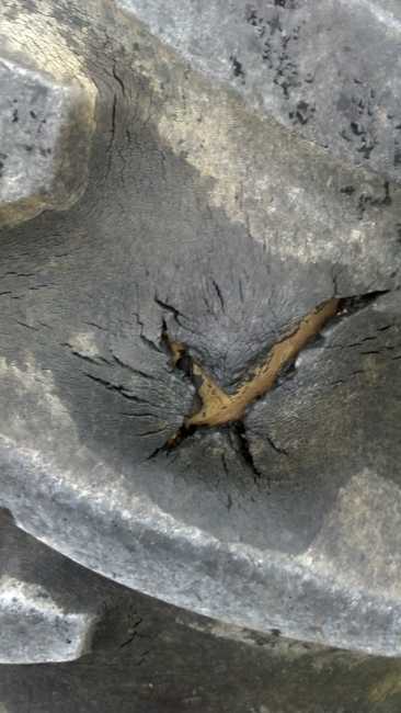

..and my calcium.
This is my fault for waiting so long but I need a decent used 18.4 x 28.
Apparently they aren't made anymore.  I found one overpriced new one 4 states away but really want a used one because my other one is still OK (not too good but OK).
I'm in Ohio.  Thanks.
For years I ran it with the fabric showing but now there is a bubble of tube showing.

Looks like you need a "rubber welder" .. I would suggest a boot for temporary but that would be a lot of work for short time it would be used. That is hope it is short time till you find one.

I realize that you want to fix it the right way, but if finding a tire is a pain, I have used some flat baler belting and glued it in as a boot before. Lasts a long time. The calcium is going to make it a little difficult.

YOU CAN SEND IT OFF AND HAVE IT "VULKINISED".

CT is right...I had a rear tractor tire vulcanised  several years ago locally and the guy guaranteed it for two years,which I thought was plenty fair. Back then it cost me 200.00,but it was a 16.9 X 34 tire with about 40% tread.  Rick
