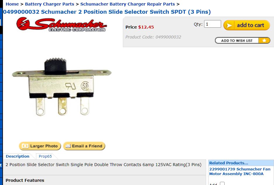

 On My Diehard 12 VDC battery charger the 3 position sliding switch that changes from 3 volt to 10 volt to 13 jump start is having trouble changing from one to other and must have some corrosion in the contacts as most of the time won't charge unless you jiggle the switch. It is a 3 position with 8 pins but only 5 of the pins have a wire hooked to it,,,?? I was able to get the PN from Sears Parts Direct as PN  0499000032 but you guessed it,,,, NLA !! There gotta be millions of switches on internet,,so what do I look for??  Most ads ask for "Pole and Throw" ,,? All I know is the switch is ON-ON-ON and most are ON-OFF-ON.

Try entering your part number in Google along with the word "switch". You should get several listings but Sears and the other sites only show 3 pins on the switch. Good luck

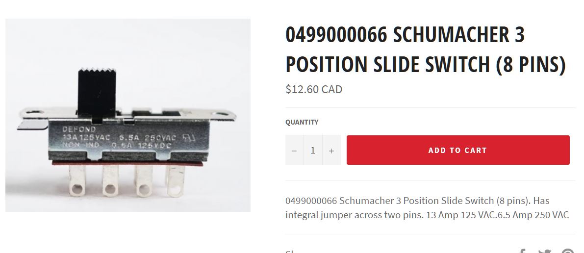

Joe... they gave you the wrong part number... Your number is a ON- ON switch with 3 pins and 2 positions...
Edited by steve(ill) - 03 Jan 2021 at 7:03pm
Points: 90826
Post Options Post Options   Thanks (0) Thanks(0)   Quote steve(ill) Quote  Post ReplyReply Direct Link To This Post Posted: 03 Jan 2021 at 7:06pm

 Aw heck,,Steve,,I had the switch apart,,(gently),,,before I read your last post and the stationary contacts on one side were worn pretty good is why it would only make contact if you jiggled the switch.
 Many THANKS for the link to ACRC Tools,,,I checked them out and found an exact switch  for only $12 bucks,,,,AND they also carry an amperes meter that is same as mine that I may order too,,!!  Many Thanks Steve,,,,ClapClap

Post Options Post Options   Thanks (0) Thanks(0)   Quote jaybmiller Quote  Post ReplyReply Direct Link To This Post Posted: 18 Apr 2022 at 11:45am
dj, checkyour OTHER 'thread'... FOUND what you need..info there....
here's the info....
The charger switch works as follows
1st position, 1--2 , 5--6 are connected
2nd position, 2--3 , 6--7 are connected
3rd position, 3--4 , 7--8 are connected
the Z strip ALWAYS has 2 connected to 7
clear as mud, right ?
You really need a DP3P slide switch.... Double pole, 3 positions.
One possible source...
dang only $3 CDN ! Digikey is GREAT....dealt with them of decades. Se what shipping costs are, minimum order and buy enough of them to make it worthwhile. if you need to buy 7, go for it....only $20.
OK I ghosted you, they're $2.22 each, shipping $5 USPS, $7 Fedex.....
man that's CHEAP !!! I'd still buy 5 of them.....no probably 10...
