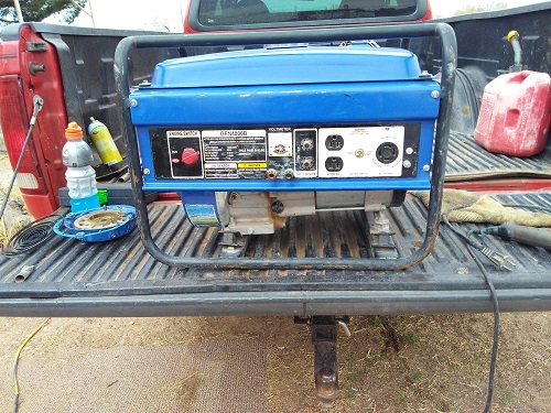

I think I got the new phone set up,,,,,,maybe,, I had to go dump the trash trailer and I run into this little number just settin there acting like it needed a good home,,,SO,,,after some gruntin and much groaning,,,I got the heavy sob in the trk. Amazing what a man can do when he gots to load and get out,,, The pull start had come apart on them,,and after a few minutes of good ole Shade Treeing,,,the float level valve had set up and not letting any fuel into the carb,,cleaned her all up,,,,rigged up a pull rope and put a spark in it,,and it runs like a new one,,,, , It is a Blue Max, GEN4000B,,,It starts on a dime every time now. I just know ole Shameless is gonna be so proud of me,,,LOL
I want to pass on something I learnt today that is a GREAT thing to know if you ever mess with pull starts on anythings,,,
I looked at several YouTube videos on how to rewind the spring on the pull start as this one is a little different from all the others I've messed with. This one video is a honey..
You DO NOT need any fancy tools,, apparattus's as this is SOOOoooo simple,,,I'm almost embarrassed I never knew this ,,me bein doin this type of work for so many years,,!!!!
1. CLEAN the spring of all oil, grease and dirt (very Important)
2. Lay the piece the spring goes in on a table.
3. Engage the " OUTSIDE CLIP" on it's tang and start winding it onto the piece it goes on. I've always tried to start with the inside clip,,,NO!!!
4. Continue to hold the already wound part of the spring down while winding the rest of spring onto it's home. VIOLA,,!! You did it,,,,
This is a very STIFF spring but I got it on there the first time without any sweat and was so easy,,,it is hard to believe,,,!! See what ya'll think,,

Yeah,,,I shoulda been a professional "Dumper Diver" this is the 3rd generator I have picked up at the city dump and prolly didn't spend $15 on all of em to get em runnin,,,Amazing what some people throw away,,,,,

Well ole Joe. Your luck seems to run much better than mine. I could probably bring ten generators home from the dumps and not have a good one in the bunch. I too recently watched a youtube video on them recoil ropes. It's like "why didn't I figure that out a Looooooooooong time ago. Looks so difficult, but turns out to be sooooooooo simple it's funny. Darrel

Hey Darrel,,,Really,,I am amazed at how simple it was to rewind thet VERY stiff spring with thet method,,, Makes me kinda mad I done it the HARD way for so long,,, Fact is,,I can remember throwin away some pull starts on weedeaters cause were so dang difficult.
Yeah,Ted this one has the 220 plug on it too,,, got a pulg I ain't seen so, will try to find an adapter for it,,
