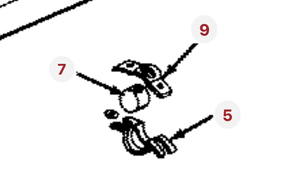

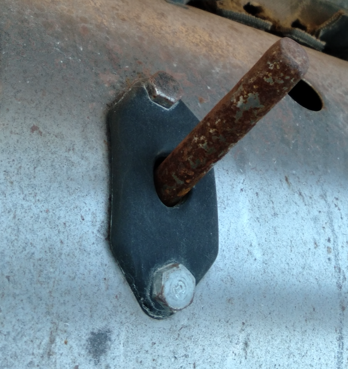

My CII has what I suspect are aftermarket guides on the pickup and feeder beater fingers, as they don't match the AGCO parts book. Most of the ones in my machine are gone from rats or are too brittle for the rats to be interested in them, so I need to replace all of them.
Has anyone had experience with both styles? Aftermarket would of course be cheaper and the guide and retainer are all combined, but if they're junk, I'll spend the money on the parts for the AGCO style.
Parts book:
My combine:

I always used the ones like you pictured.
Points: 22171
Post Options Post Options   Thanks (0) Thanks(0)   Quote DrAllis Quote  Post ReplyReply Direct Link To This Post Posted: 21 Dec 2024 at 8:33pm
You haven't been able to buy the 2 piece for 40 years or more.

Post Options Post Options   Thanks (0) Thanks(0)   Quote wjohn Quote  Post ReplyReply Direct Link To This Post Posted: 21 Dec 2024 at 10:38pm
That's interesting to hear. All of the old style parts listed in the C/CII catalog show current pricing and stock available, including the metal retainers. Sounds like I can save some money and use the one piece poly ones.

My F2 has the plastic ones in platform conveyor. They are kind of fragile. You can squish the hole apart with too much tightening. I use Loctite on threads and snug firmly. I just replaced some this fall. My help was running machine and I was standing on end as she finished the through. SOMETHING DON'T SOUND RIGHT!!! The help never knows something is wrong by the sound. Let's call it inexperience. 2 completely missing on platform with fingers rattling! I usually rub the clutch and roll machine over while looking for guide trouble first of each day but I wasn't driving and can't remember everything to tell everybody.
Plastic ones ain't exactly cheap.

Like SteveM (cIL) stated earlier, the plastic guides often break & probably get ingested by machine? If you quickly catch a missing guide, their replacement is minimal effort. Let it go too long & you could be refabing the mounting area that becomes bent-in from constant bashing.
Maybe look for the cast metal replacement guides offered by AGCO? They are pricier, louder during operation, but will last a long time.

I have one hole completely missing the finger, guide, and hardware that looks like it will need to be straightened so that's probably what happened to it. Thanks for solving that mystery.
I did see the cast or forged guides and yes they are pricey. I was planning on skipping out on them since they probably wear on the fingers much more than the plastic? I did see somewhere in my research that forged guides were part of the corn/soybean special package, and were recommended with corn which would make sense. I don't have any irrigation on my land so I won't have to worry about corn, at least - just wheat, soybeans, and milo.

My A2 had plastic in both conveyor and beater. Did about 40A corn per year for 19yrs without much trouble. Just had to keep eye on them. My F2 has steel guides in beater with larger fingers. It is a corn/soy special.  I think it's 5/8 VS 1/2. Has around 4000 engine hours and has done the same 40A corn per year for 24 yrs and while there is wear on the fingers and steel guides it's not that much. The tips are worn worse that the shanks.

Thanks - that's good to know that the metal guides don't wear the fingers that much. Most of my fingers will be reusable so I'll look at whatever guide options are available for the smaller diameter fingers that my combine has.
