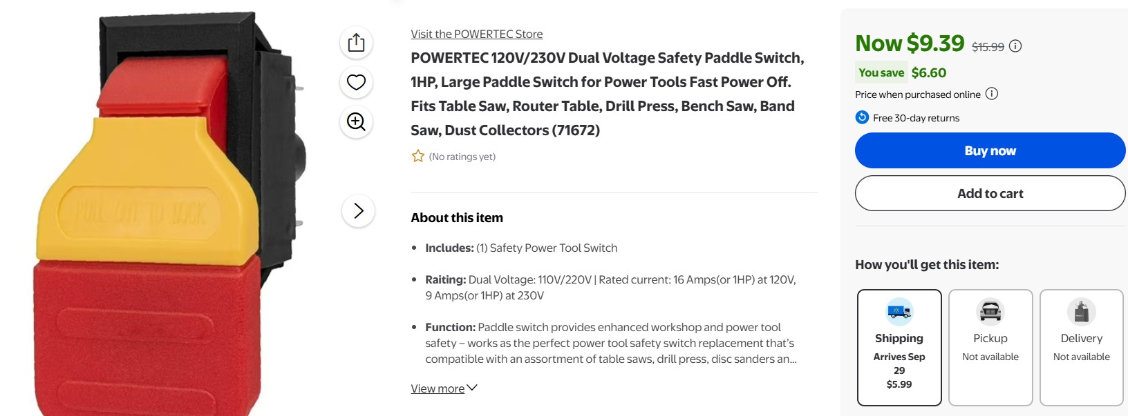

yes, any Heay Duty swtich will work... Mine is 220v and i used a double pole, single throw switch like a light switch.. but rated at 20 amps and twice as big.. Still fits in the standard 2 x 4 box.. ... Look on AMAZON and type in 220v switch and you can get light switch, paddle switch, similar to breaker handle, etc..
something like this...

Thanks Steve, that Home Depot switch is the type I want. My saw is 110 . I'll take my old out and go from there.

Ordered and finally received a new switch. All I got was the switch itself, not the whole unit. Tried to put my old paddle stop on with no luck. Maybe I can get a corded switch with paddle stop that will work? Anyone have any experience with this? Thanks!

I got what I ordered just didn't work like I'd hoped. Does turn my saw off and on
Do miss the paddle stop though. Didn't think you could return electrical stuff anyway. Thanks
Points: 88079
Post Options Post Options   Thanks (0) Thanks(0)   Quote steve(ill) Quote  Post ReplyReply Direct Link To This Post Posted: 19 Sep 2025 at 8:24am
Wal Mart sells a similar switch . Check the AMP rating for 120v... Some of the smaller ones are 10 amps... The larger are 16 amps... Your not pulling that, but heavy duty might last longer.
