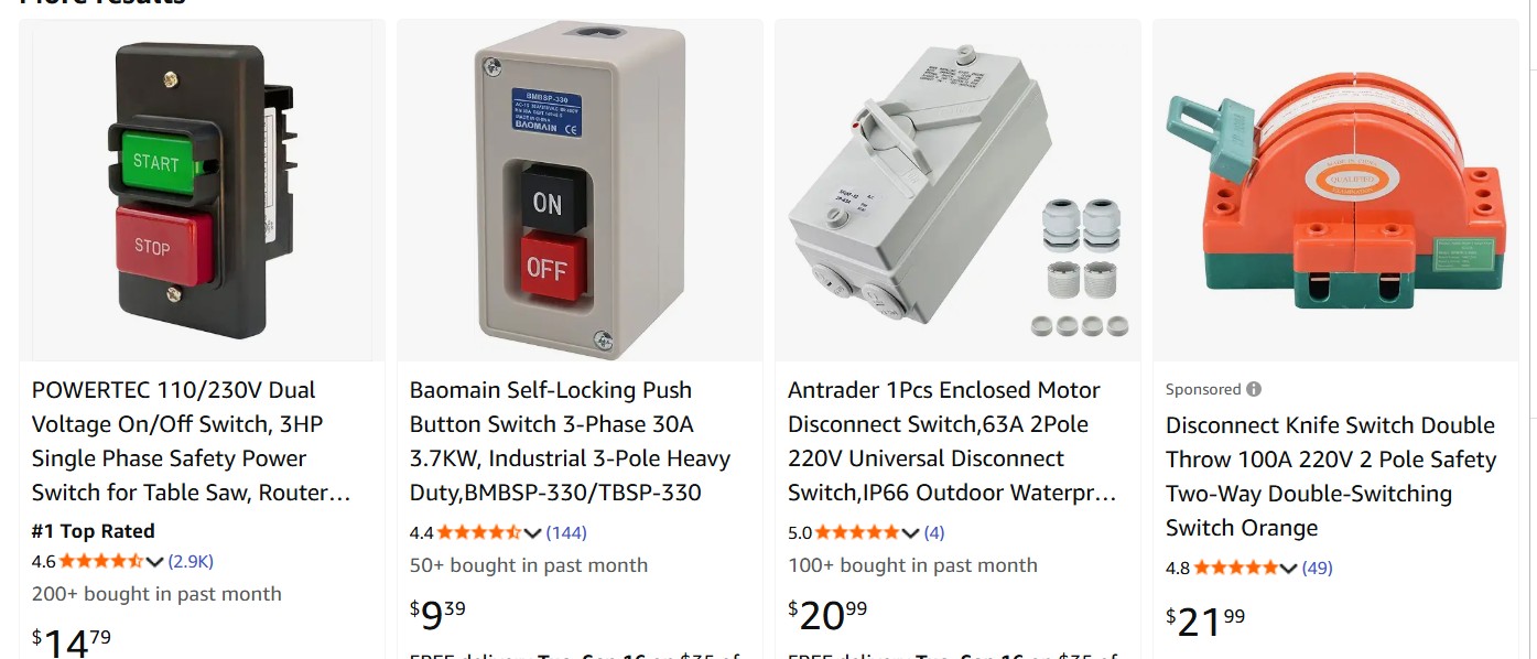

yes, any Heay Duty swtich will work... Mine is 220v and i used a double pole, single throw switch like a light switch.. but rated at 20 amps and twice as big.. Still fits in the standard 2 x 4 box.. ... Look on AMAZON and type in 220v switch and you can get light switch, paddle switch, similar to breaker handle, etc..
something like this...

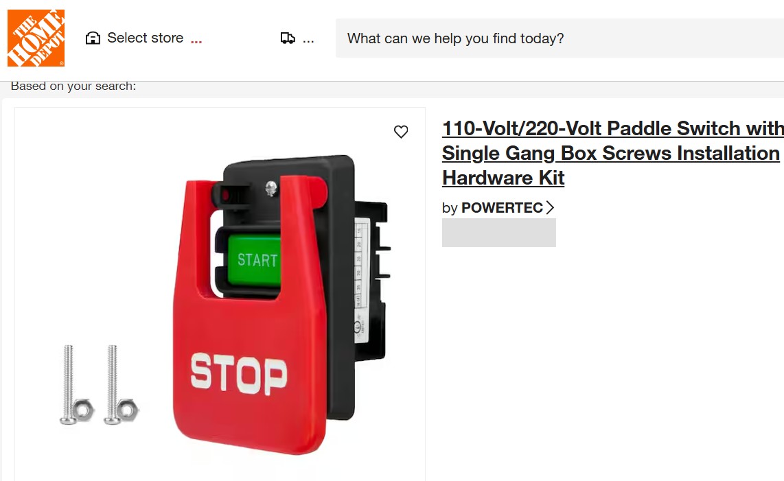

Points: 90838
Post Options Post Options   Thanks (0) Thanks(0)   Quote steve(ill) Quote  Post ReplyReply Direct Link To This Post Posted: 11 Sep 2025 at 5:44pm
ACinSC View Drop Down
Joined: 16 Dec 2015
Location: South Carolina
Points: 3252
Post Options Post Options   Thanks (0) Thanks(0)   Quote ACinSC Quote  Post ReplyReply Direct Link To This Post Posted: 11 Sep 2025 at 5:51pm
Thanks Steve, that Home Depot switch is the type I want. My saw is 110 . I'll take my old out and go from there.

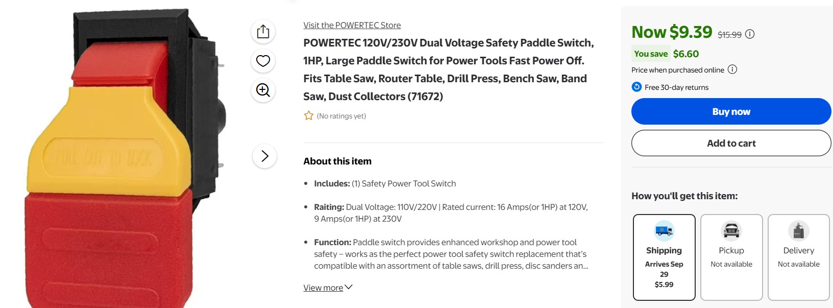

Wal Mart sells a similar switch . Check the AMP rating for 120v... Some of the smaller ones are 10 amps... The larger are 16 amps... Your not pulling that, but heavy duty might last longer.
Joined: 16 Dec 2015
Points: 3252
Post Options Post Options   Thanks (0) Thanks(0)   Quote ACinSC Quote  Post ReplyReply Direct Link To This Post Posted: 19 Sep 2025 at 10:01am
Thanks Steve!
Joined: 16 Dec 2015
Points: 3252
Post Options Post Options   Thanks (0) Thanks(0)   Quote ACinSC Quote  Post ReplyReply Direct Link To This Post Posted: 26 Sep 2025 at 4:36pm
Thanks Steve! I ordered the Wally world switch. Installed it today, works well and nice to have a paddle stop again. Live and learn I guess.
