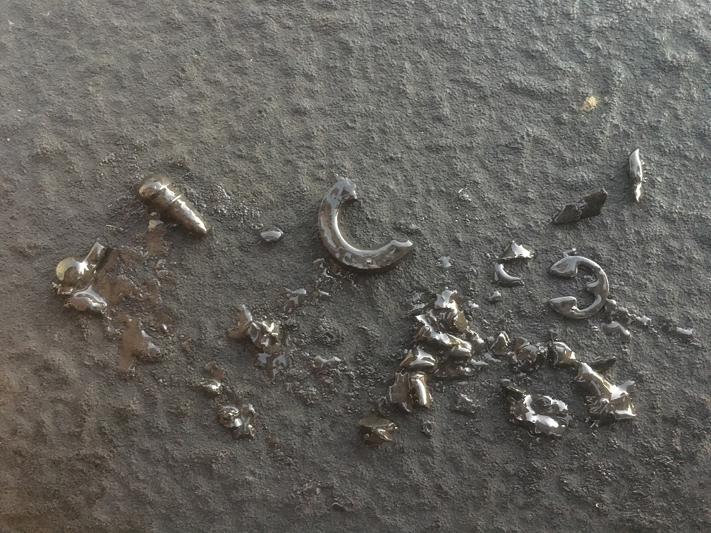

Found these in the oil pan of a 190 gas.  Any ideas on what they came off?

Does it still run? Or a non runner?
Points: 22325
Post Options Post Options   Thanks (0) Thanks(0)   Quote DrAllis Quote  Post ReplyReply Direct Link To This Post Posted: 20 Nov 2016 at 12:54pm
Governor.

I haven't started it.  It sat for several years before I got a hold of it and the owner wasn't sure of its history.  I figured it was likely part of the governor.  Is that clip one of the ones that holds the weight pin in place?

c clip from governor weight pin definitely, rest looks like exploded weight pieces
