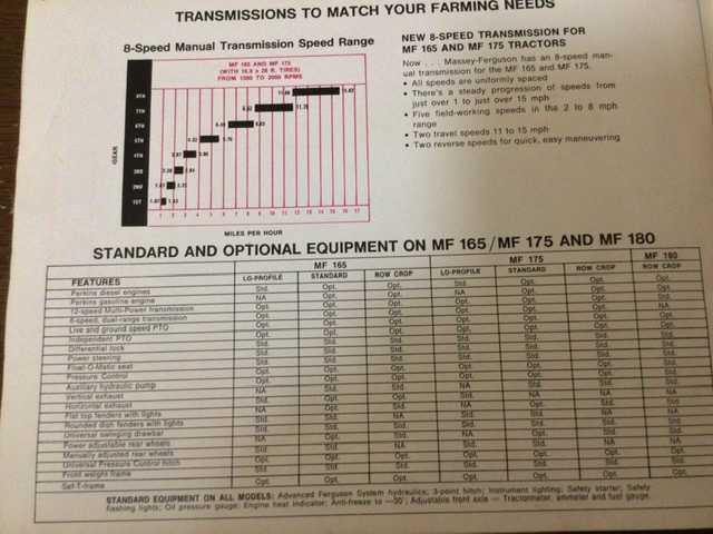

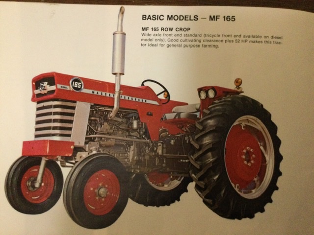

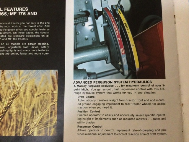

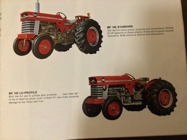

I am surprised at some of the responses. We had zero problems with our unit. But it was purchased new and we did not abuse it. It had an Allied loader on it - dealer installed. I did a bit of work on my friends MF175 about 4 yrs ago. Water pump and thermostat, some new belts and oil change.  Got all parts from my Agco dealer in a couple days. Price was fair and parts correct.  Smile😀
The engine for the MF165 was Perkins AD4.203 with 17.5:1 compression. It would start anytime without block heater but we did usually use the heater if possible.

It may all be perspective... I grew up with a narrow front WD with no power steering and a WD9 loader!
Also came to find out later in life that one of the front tires was an inch wider than the other, so the narrower/shorter tire wasn't touching the ground much if ever. Man that thing is fun to turn with a load in the bucket.
I am hoping to take a look at the 165 next week and learn more about the rim/tire situation and what options it has.
