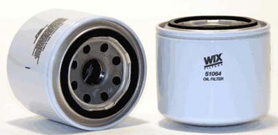

Anyone know of an interchange for GH100860 or 100860? Need one and dealer is too far away for my schedule this week.Thanks

wix - 51064
NAPA -1064

http://www.fleetfilter.com/filter/wix-oil-filters/51064.html
Product Categories: Wix Filters - Oil
Wix 51064 & Napa 1064 Oil Filter
Wix 51064 & Napa 1064 Oil FilterQuantity in Cart: 0
Code: 51064
Retail Price: $13.49
Price Each: $7.00
At $125 order: $6.3
At $500 order: $5.6
Case Qty: 12
Quantity: < ="text" name="Quantity" value="1" size="4"> < ="submit" value="Add To Cart">
"PARTS DETAIL
Principal Application: Airman, Bolen, Case, Hitachi, Jacobsen, I-R, John Deere, Kubota, Vermeer, Yanmar, Kia, Hyundai, Mitsubishi Transmissions, Other
Style: Spin-On Lube Filter
Service: Lube/Transmission
Type: Full Flow
Media: Paper
Height: 2.944
Outer Diameter Top: 3.243
Outer Diameter Bottom: Closed
Thread Size: 20X1.5 MM
By-Pass Valve Setting-PSI: 16
Anti-Drain Back Valve: Yes
Beta Ratio: 2/20=14/30
Burst Pressure-PSI: 355
Max Flow Rate: 9-11 GPM
Nominal Micron Rating: 21
