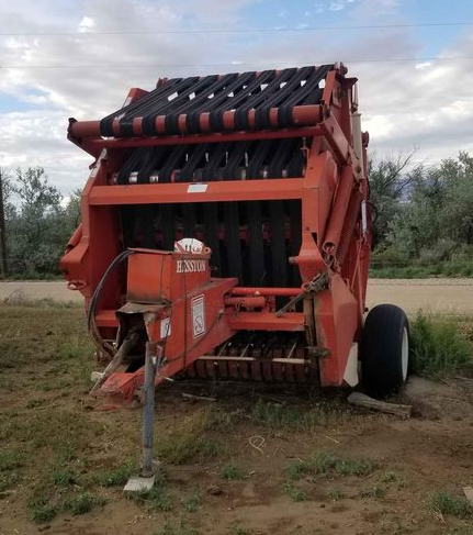

This year, we're going to be putting up a lot more straw! Mostly in small squares, but we're looking to do 150-200 acres of rounds. I have a John Deere 530 that was supposed to be working when I bought it, but the twine arm isn't right, so it's at a mechanic. We have about a month until we need to start baling, so yeah.... Not a whole lot of time. So, I've been doing what any person idiot would do and I checked the local classifieds to see about a backup machine. Finding hay equipment out here is virtually impossible, so yeah...
But I did find a baler, about an hour away. It's a Hesston 5500 Rounder. Here's the description from the seller: "Hesston rounder, good tires, good belts, good chains. Stringer mount needs repaired. Used last summer."
My questions: Are these things any good, or should I be running for the hills? We're going to be putting up that 150-200 acres of straw, and the neighbor has been heavily hinting that he'd like us to bale his cornstalks if my round baler is fixed. I can't imagine us doing hay- just straw and cornstalks with the baler. Our climate is bone dry and hot here, so material will always be bone dry too. I know nothing about these- this is our first year doing rounds. It's a $1000 baler, so my expectations aren't high, but is this something I should be looking at or should I just run?
These are the three photos of the baler in the ad:

I had a 5500 in the 80s. Good for hay if it wasn’t too green and windrow wasn’t too big. It took some skill to start a roll. May be ok for straw but doubt it would do good in cornstalks. Friction tape on drive rollers helps.
I’d recommend a Vermeer Super J with spiral roller.

I have one of those balers, they were designed for corn stalk baling. i've done alfalfa with mine and it did just fine. I can't tell in the pics if there are steel fingers mounted on the belts, they help lift and pull the material in.
