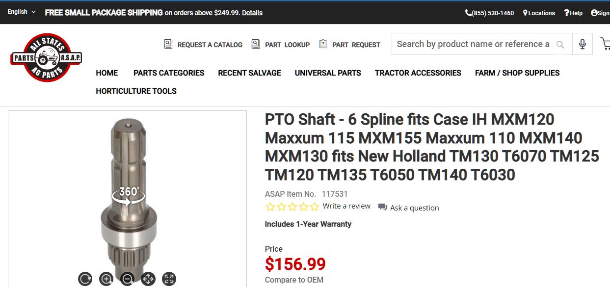

Post Options Post Options   Thanks (0) Thanks(0)   Quote steve(ill) Quote  Post ReplyReply Direct Link To This Post Posted: 30 May 2023 at 8:38am
does it look like this ?
Post Options Post Options   Thanks (0) Thanks(0)   Quote shameless dude Quote  Post ReplyReply Direct Link To This Post Posted: 31 May 2023 at 2:34am
no Steve...the bearing is behind the sprocket on the 1000 that we pulled out. and  the dealer I bought it from got me an owners manuel, and when they tried to mail it to me, the post office returned it to them saying they can't mail a box to a PO box!! BUNK! I get boxes all the time to my PO box. I called them back and told them to UPS or FED EX it to me! still waiting for it! 1000 and 540 shafts are different sizes. thank you all for your responses !

I got the owners manuel in the mail, reading thru it found out when the tractor was new it came with both PTO shafts, the 540 one is missing, i'll go buy one this week, then i'll have both. thanks for most of you's help!
