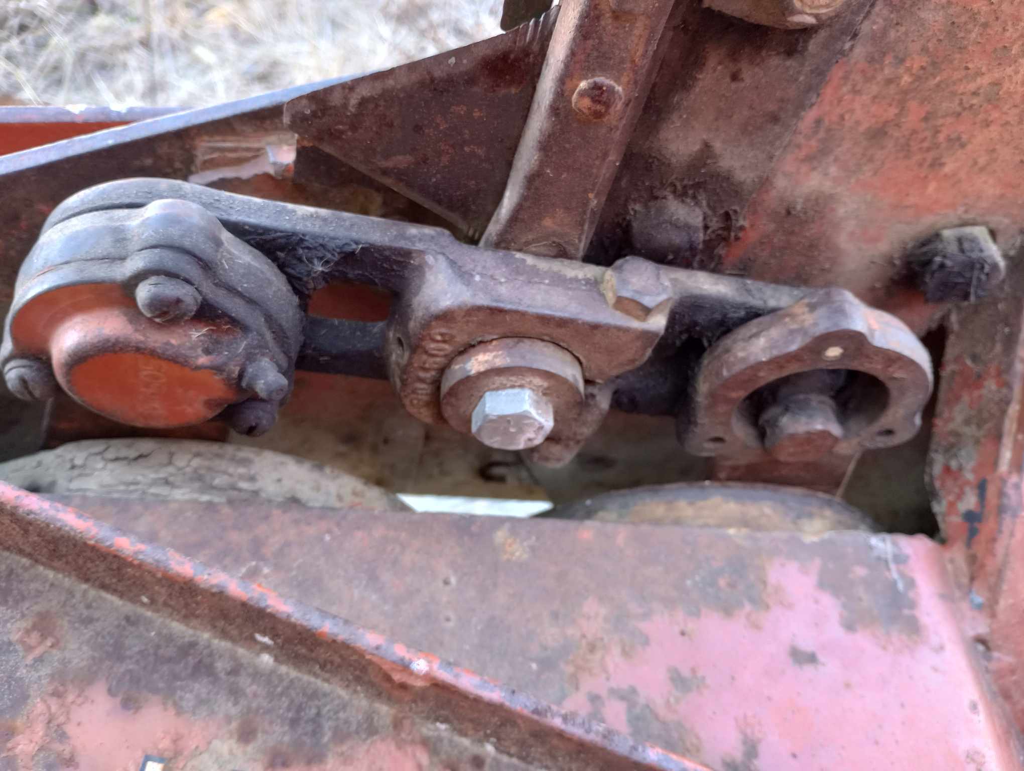

uploads/11350/mower_bearing_1.jpg
To make sure I have the right number this is a picture of the bearing that is out.  I can get it really cheap, but just want to make sure I can get parts.

That style connecting rod and bearing is not #7. That’s off later style mowers. That stuff is still available through agco

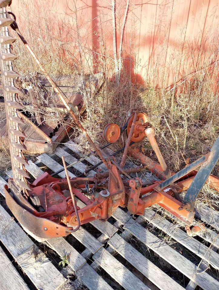

uploads/11350/mower_converted.jpg
Can you tell me what model this is, he said he converted it to 3ph, i thought it looked like a no 7 I used to have one years ago.  Only wants 75.00 for it.

I’d buy for 75.
That’s a late model 80r that someone cut the snap coupler off and welded brackets on
Boy, I would like to see the Agco prices on any of that stuff today it they still have any in stock but I'm not going to take the time to look them up. Some of you young guys can do that!
The connecting rods are definitely the newer style. However that style uses the  same bearings (304 and KP-8) used on the earlier style.
I think Mike z. nailed it; this appears to be (maybe) an 80R mower that was adapted to 3PH by cutting the frame and welding on 3PH components (the black parts).
This may be a later 80R mower given it has the ball bearings at the pivot points on the ends of the gear case. If that is the case, the cut bar may be 3/4" thick instead of the 5/8" thick bar used on the #7 and some early 80 series mowers. I consider these two of the biggest improvements made on these mowers.

That cap that covers the bearing may be a little hard to come by but may still be available at Agco. Maybe check with Mikez?

I’d buy for 75.
Mainly all I was looking for was something to cut ditch banks with.  If I can get the parts and since it is only about a two hour drive from my house.  I would consider buying it.  Wish it still had the snap couple on it.
