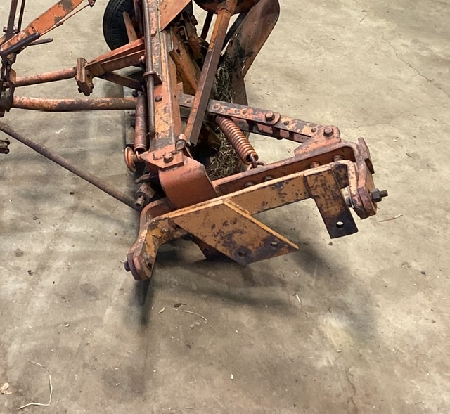

I thought this was the mount for the WC. I’ll attach a better picture.

I got a length of oak from HD and made my own pitman.  The remains were there so I did have a pattern to use.  The No. 3 uses different adapters for different tractors.  I can't tell from your pics, but you may have the correct one for the WC.  I gave away my books to the guy that bought mine so I can't be sure, or that one may be for the B/C hook up.  The adapter I needed was for the WD/45, I found it on here and got it from a guy up in ID I believe.  Good luck with your mower.
In case you didn't know.  That bent rod down thru the center of the mower is for holding the bar up during transport.  You are missing the nut unless you took it off for safe keeping.

Sorry I stand corrected on the mount. It is for a WC. Sorry. I do have the pitman stick dimensions if you care to make your own. The link below is for your hitch. https://na.apb.agcocorp.com/p/agcoallis/9001530b/l/18?tocGuid=f422496f-6855-1a16-8cdf-4ad2299f6d23

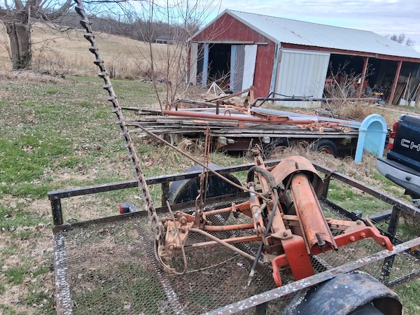

Looks like it, except this one has a hydraulic cylinder on it.

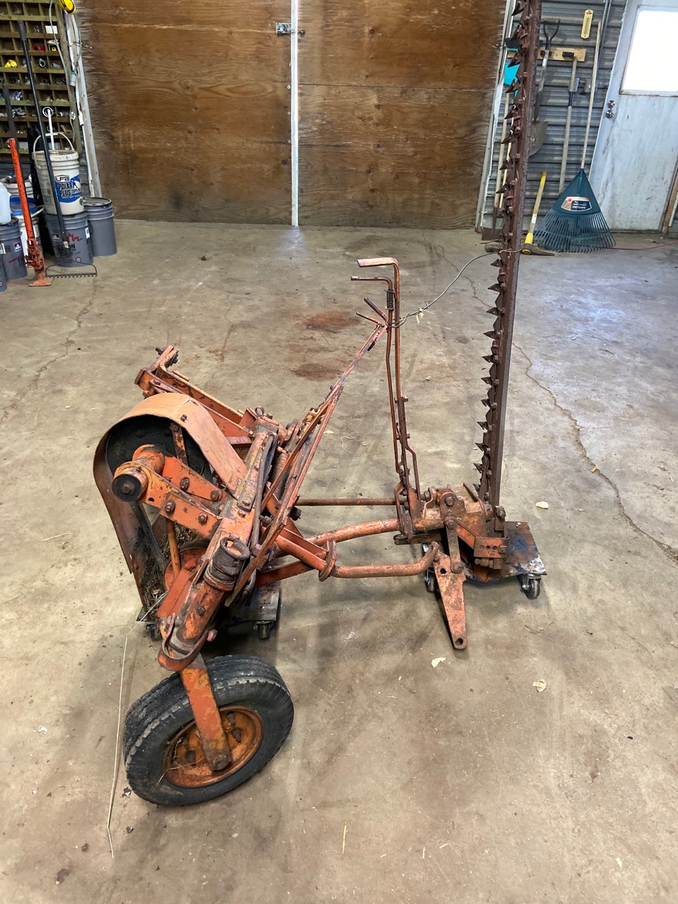

Here is one of his pics. It is a number #3. How did they have it mounted?

The CA he had it mounted on was not a snap couple, the arms were turned down and a bracket went down and had a piece that went from arm to arm and was bolted to the draw bar, it had to mounting points and the arms that went down to the draw bar.  But mine is a snap couple, I did not see any cylinders on his lift arms????
