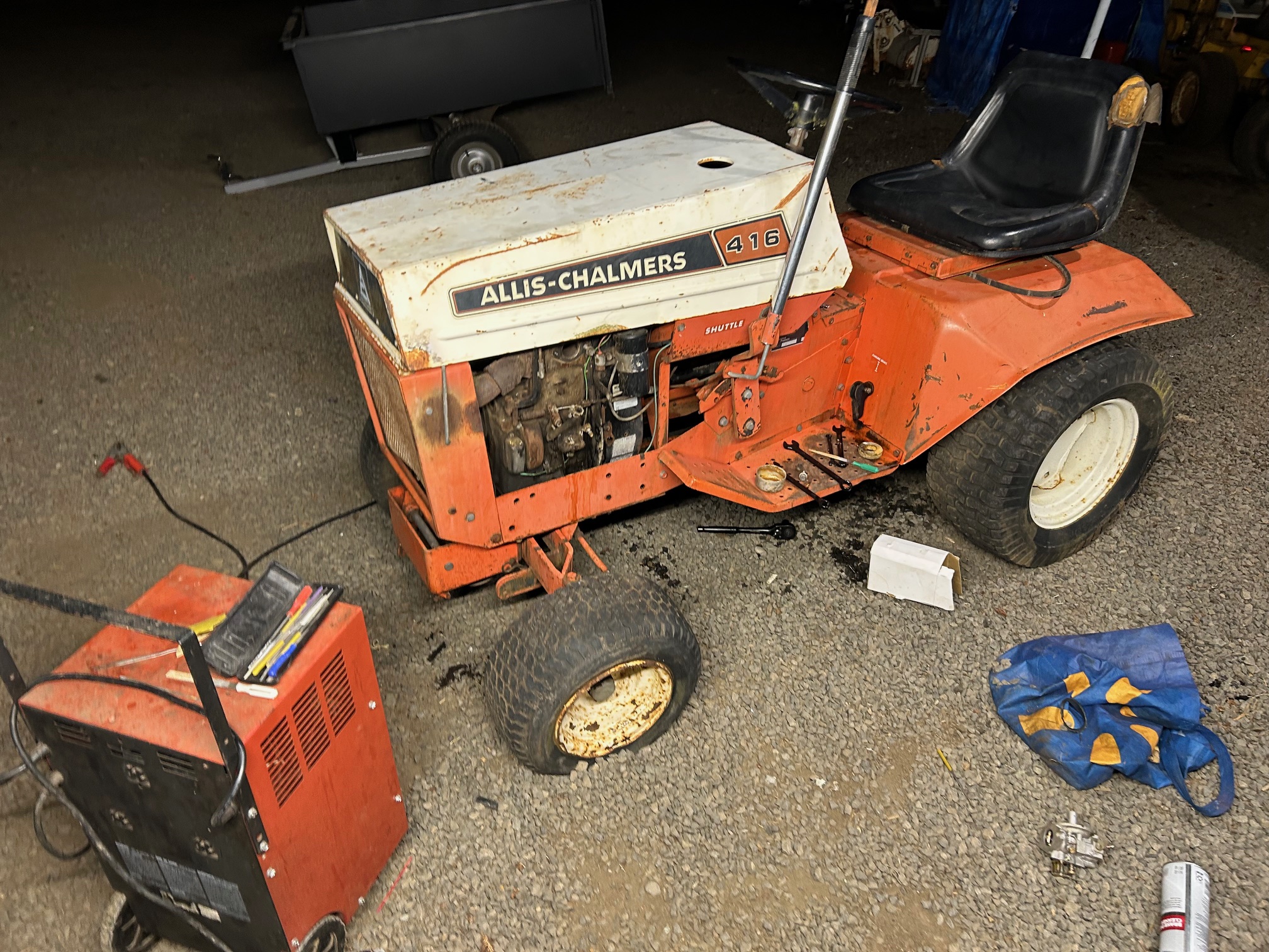

we just got this gem for 30 bucks
with deck
were working the carb over its pretty rusty and gummy at the same time
 found this serial ( 260414630) would love to know what year it is and we need a parts breakdown or service/ repair guide to put the rear brakes back together and just have the basic knowledge base for getting it in shape again

It’s a 1973, only built one year (to be exact nine months I read somewhere).

Top one gets 1 1/2 turns out and the other that’s at a 45 degree angle gets 2 full turns out.
That should get you running.

I should have said to gently turn both screws in first until they gently bottom out..
