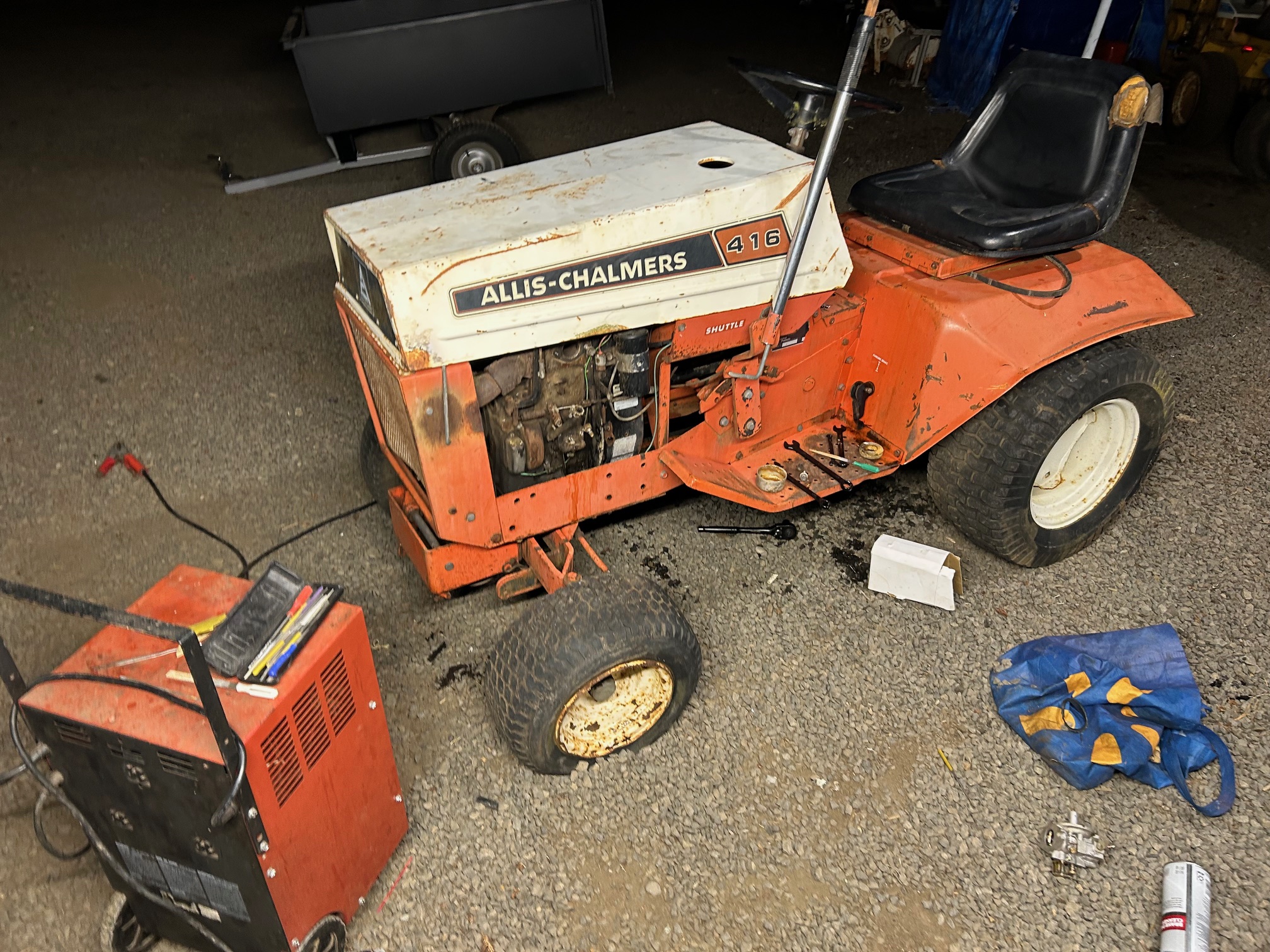

good evening from the Pacific Northwest
we just got this gem for 30 bucks
with deck
were working the carb over its pretty rusty and gummy at the same time
 found this serial ( 260414630) would love to know what year it is and we need a parts breakdown or service/ repair guide to put the rear brakes back together and just have the basic knowledge base for getting it in shape again

I can get you some pictures of mine that might help.
It’s a 1973, only built one year (to be exact nine months I read somewhere).

does it have a section for adjusting the carb?
that would be really helpful as well as the breaks

Top one gets 1 1/2 turns out and the other that’s at a 45 degree angle gets 2 full turns out.
That should get you running.

I should have said to gently turn both screws in first until they gently bottom out..
