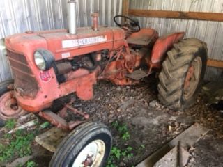

Hello,  I purchased this D14 today. Not sure of the year yet, I am still working on getting it out of the barn and on to the trailer. Tires were flat, pumped them up and are holding air well enough to get onto a trailer. The two back tires are leaking at the valve stems.  Took carb off and did a quick clean, drained gas, put new gas in.  The battery they had in it was a 12 volt with negative to ground.  I put a 12 volt marine battery in and just get a click when I try to start it. Lights are bright. The one gauge reads 15 amps. Just by looking at the generator, I am thinking this is suppose to be a 6 volt positive ground system.  How would I check for 6 volt rather than 12?  Dosen't 6 have more cranking amps?

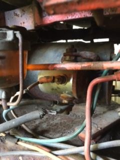

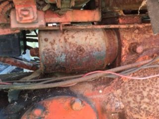

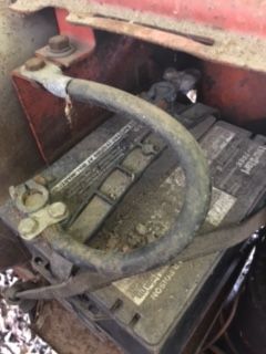

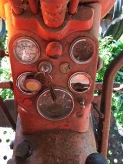

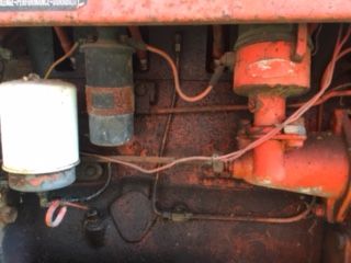

Sorry, these are all upside down.  This is what the tractor had when I found it.
 (12 volt battery, negative ground)     (solenoid?  (on left side of starter as sitting on tractor))
 (generator?)  (black cylinder, a coil?)

Ok...
first, pictures... you need to find the 'option' on your 'smart device' to 'lock orientation', that way pictures will be right side up.
second, wiring. Do yourself a BIG favour and get rid of 100% of what's there! You've got 50-60 year old wiring and NONE of it will be any good. You'll waste a LOT of time trying this and that,testing here and there, and well, the gremlins WILL win. For 'testing' you really only need NEW starter cables and a wire to the ignition, and another to the starter solenoid. If you're not comfortable with wiring, buy a kit from Steve at B&B on this site, though I've redone 3 out of 4 of my D-14s and they run just fine..
3rd. if it hasn't run for awhile, you'll probably need to clean the points as they get corroded over time. Maybe replace all 4 spark plugs. Firing order is 1243 with #1 being closest to the rad.

Well, if you put a 12V in it and turned the lights on and the lights or the fuse didn't blow, then it's probably now a 12 system. They did leave the factory as a 6V positive ground system, at least the very first ones did, not sure about toward the end. If it's only clicking, then the starter solenoid maybe shot, or by the looks of it, the wires going to it look pretty crusty.
The coil  may have a 6v or 12v marked on it somewhere if you can get it cleaned up enough to read it. The Genny, if it still has a tag, you can take the model # and Google it on- line.

starter. IF there's a metal band around the end away from the engine, odds are real good it's a 6 volt starter. NO band ,it's a 12 volt unit. I have 3 with band..all 6 volt,other is 12V.
Honestly ,get rid of the wiring.Spend $20 and get new battery cables and properly install them. That way you can safely use the starter solenoid to turn over the engine without major sparks.emember ther's a  gas tank on top of the starter !!
By getting rid of the wiring the generator is just a 'pulley' for the fan belt,so you can hurt it and it can't hurt you or fry up the 60 year old wires( which you've gotten rid of).
I know I sound anal about the wiring but age, mice, corrorsion will play havoc with wires.Either no power goes through or gets shorted to the wrong place and 'nothing happens', except you've wasted 4-5 hours of your life.
You NEED new wires anyway,so just buy the starter cables.If it spins then you know the solenoid is good as well as the key switch.

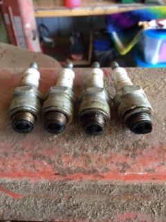

Pull the spark plugs and see what they look like. If all 4 are 'tan' coloured great, any 'oily' ones aren't so great.

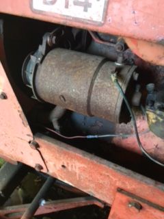

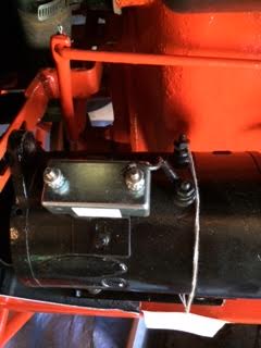

Thanks Jay.  I got the wiring diagram.  Here is a picture of the starter.  I do not see a band.
I took the photos with my phone, sent them to my computer.  They look fine on the computer but then turn upside down on the forum.  I will try to fix as Jay mentioned in an earlier post.
Edited by HVFDFIREFIGHTER - 21 Jul 2016 at 7:55am
Points: 25256
Post Options Post Options   Thanks (0) Thanks(0)   Quote jaybmiller Quote  Post ReplyReply Direct Link To This Post Posted: 21 Jul 2016 at 6:29am
I'd say that's a 12 volt starter, sure is sad to see that much rust on the tractor though !
OK, on the bottom of the bell housing there's a 3" hole plug. Pop it off, shine a light in there, see how big a 'mouse house' you have. Normally you should just see clutch parts but mice LOVE that area. If it's full, you'll have to remove starter as it's be jammed with mosue house materials. Mine was so jammed starter would NOT spin over!

If in fact this is a 12 volt system, I'm assuming this is still a 6 volt generator.  It would still charge, just not as quick correct?  I notice there is no cutout (silver rectangular box) on the generator like my WD has. This one has just two posts.  Left photo is from D14, right photo is from WD showing the cutout relay

Any D-14 has a voltage regulator, not a cut-out. It's right there behind your starter.

So this is the voltage regulator.  Wire on top, wire on bottom, and wire on side.  It is attached to left side of genny, kinda behind the gas bowl.  The wire on the bottom looks kinda frayed in this photo.   Once I get her home I will be replacing all of the wiring as Jay mentioned.  Currently out in a barn with no electricity. The tractor was stored for years under a roof but open to the weather.
Points: 25256
Post Options Post Options   Thanks (0) Thanks(0)   Quote jaybmiller Quote  Post ReplyReply Direct Link To This Post Posted: 21 Jul 2016 at 8:31am
no, that's the starter solenoid, with really, really bad wires on it !
The little wire gets 12v from the ignition switch, in the start position which then allows full battery power to go to the starter.
when you get her home, come on back....
......um, no thats the solenoid you have pictured there.....voltage regulator is the square black box looking thing.

Post Options Post Options   Thanks (0) Thanks(0)   Quote Steve in NJ Quote  Post ReplyReply Direct Link To This Post Posted: 21 Jul 2016 at 8:49am
I'm just coming on to this, but that is your Starter relay that kicks the Starter motor in. It looks to me as the cable running to it is partically severed or just about rotted off. That will never start with the cable that way. The thing I would do first is see if the engine turns over by hand. If it doesn't, throwing cables and parts at it to get it fired up will be a waste of time if the engine is stuck. The second thing I would do is check the serial number of the Tractor to ID whether it was originally 6V or a later 12V version. Looking at the pic of the Battery, that Battery is a 12V maintenance free version. Doesn't mean its correct. Looking at the Generator chassis, it could be a 6V or 12V with or without a band. Some 6V versions were closed chassis units also. If the engine turns over by hand then I would go with what Jay mentioned with cables, but you have a LOT of cleaning to do at all the connections to even make an attempt to start it. Personally, I think you would be better off getting some help to get it out of where its at onto the trailer and getting it home in your barn or garage to take your time and tear it down to get it in some sort of shape to try to fire it providing as I said that the engine isn't stuck from sitting. HTH

I got her home today!  Took plugs out, put PTO in gear, put my pipe wrench on, it would't turn by hand.  Stepped on it and it turned about 1/4 turn.  Now cant get it to move. Which way should it turn?  As I am looking at the back of the tractor, clockwise or counterclockwise.  I turned counterclockwise.  I did not try it in fourth gear yet.
The spark plugs did not look good. Not rusty but oily and black.
