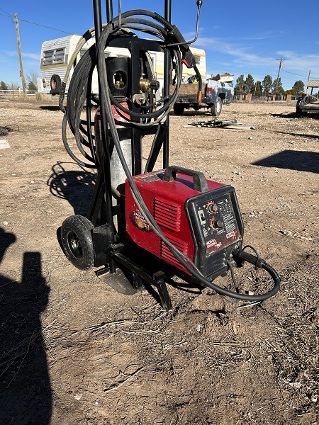

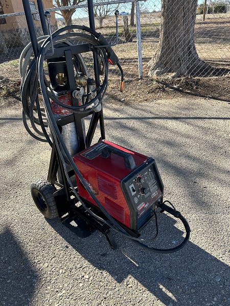

  Well,,after a few false starts,,I finally finished the mig Dolly Cart and I really like it much better than the 4 wheel model I had before.  For main thing,,,I wanted a LOW center of gravity for use on areas with out concrete. The Dolly frame just lends itself to being able to maneuver it many wonderfuls,,!!
 Many THANKS to Steve(ill)  for his design,,,it worked out great!!
 I might of fudged a bit in that I robbed two of the pneumatic tires from the old cart just to give em a tryWinkWink ( Thanks DIYDAVE) still have the hard rubber ones of these don't work out. I was kinda concerned about the weight of the CO2 cylinder shifting around so I put a 3 1/2" muffler clanp  under the plastic handle and bolted her down,,,it ain't gonna move for chit,,,,!!!

 By the way,,,here's another shot of the "STEVE CLONE",,,,ClapClapClap
 I'm sure proud of it,,,!!

Looks sharp, Joe!!

Wow Joe, that cart looks great, between you and Steve you guys could go into fabrication, looks better, stronger and more practical than anything you could pull off a shelf anywhere. Let me know when you start taking orders. Side note, have you heard anything more from Shameless.
