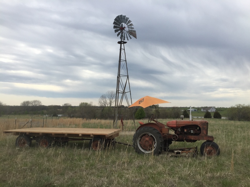

Well, I finally got the new deck put on the wagon. Just wanted to share pictures.

Looks good. Heavy duty.
Post Options Post Options   Thanks (0) Thanks(0)   Quote shameless dude Quote  Post ReplyReply Direct Link To This Post Posted: 01 May 2018 at 12:03am
good job Michael! you gonna put an edge on it?

Great job! 8'x14'?

This what it looked like before his started, I think he has done a fine job rebuilding it maybe he will tell just what it needed done to the wagon gear.

It is 8’ x 16’, 4”x 6” x 16’ stringers, 9 3” x 4” x 8’cross braces on 2’ centers, 1.5” x 6” x 16’ top boards with the two side boards being 1.75” to make a lip so stuff won’t slide off. All the wood is dimensional rough sawn white oak with 3 coats of linseed oil.I still have to put the two front boards to make the 1/4” lip on the front and back and then the side boards. To the gear itself I was lucky Albert at the AGCO dealer in maryville mo found me the following new idea nos parts: set of wheel bearings and seals, front spindle, center steering bushing, 2 stringer braces, eyebolt for the 3rd axel. So I pulled the pole apart and wire brushed it and cleaned it good so it won’t freeze up again, cleaned and repacked the 5 good Bearings, installed the new set udjusted the tie in and out on the deck. don sold me the gear in the first place which was earful nice of him to part with it. I built it to use in case I ever need to but truth is it won’t ever get used much except for a chore wagon and wagon rides and taken to some ac shows. I was able to even find 2 oos old old stock Goodyear tires from Austin’s salvage to match the other 4. Matching old tires is nearly as hard as finding nos parts. Thanks to all who have commented.
