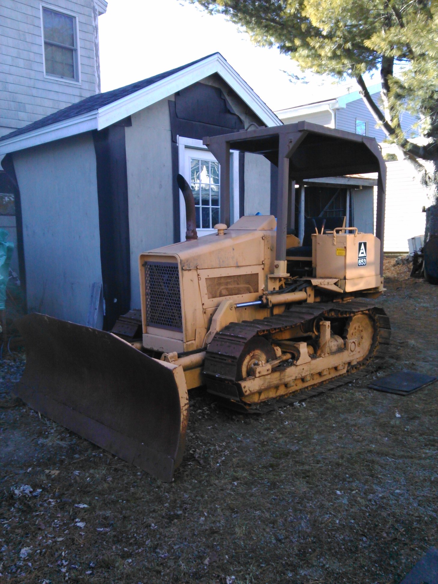

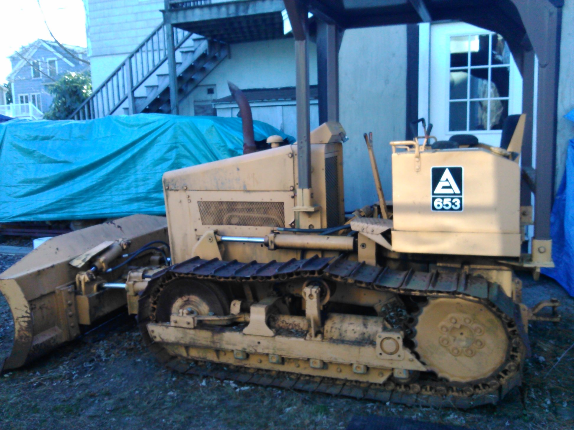

Hello all, new member here cause i just picked up a nice little 653 a few weeks back.
I have been reading all i can around here ( i think i have read damn near everything back to page 42 so far...) but, hey its cold and ridiculously snowy outside so what else can i do. Its a good thing i grabbed it when i did, we just passed the 100 inches of snow mark so looking at the UC would have been real tough if i waited. Anyway, it runs well and is generally quite nice. Needs new brake bands as they are worn to nothing and as a result the steering clutches are also stuck. Not sure how bad, i guess new brakes and a workout to see. Its been sitting several years with periodic starts and a drive back and forth to keep everything moving. Its too bad the lack of brakes made keeping the clutches free impossible. I shall need to fix the track adjuster on the left side as well, it went out and they welded a shim in there to finish the job. The final seems to weep a little oil on that side as well, not a major leak but something i'll see about fixing. Need to get the service book and see how big a job that is. Overall a very nice little bugger at a price i can't complain about. Now if only the snow would leave so i can have this thing dropped off and start to get her ready for some fun time.

Congrats and welcome! That is one nice looking machine!
I wished mine looked that nice. I picked up a 653 this last summer and it needs new steering clutches and brakes. I need to finish rebuilding the steering clutches, but it's just been too cold to work out in the barn. Mine were pretty tough to get out as it seemed every pin was seized since it was sitting for a few years and water got into the housings. Once it warms up, I'll finish the clutches, change some hoses and give it a coat of paint.

"I have been reading all i can around here ( i think i have read damn near everything back to page 42 so far...) but, hey its cold and ridiculously snowy outside so what else can i do. Its a good thing i grabbed it when i did, we just passed the 100 inches of snow mark " Well, you could be pushing snow instead of reading in the warmth of the inside... LOL
  Glad you found your way on here...and we like pictures...
 Need any info, just ask...

REALLY NICE LOOKING UNIT.

That has a UniTool cage on it. Those are pretty neat. I have one I modified , as the mounts aren't the best for pushing trees. Tracy

Interesting, i have seen pics with 2 styles of cage. I'm just glad it has something on there. My current dozer is a T340 international and it has nothing. Thats finding a new home and this is the upgrade :-)

Nice looking machine, too bad it wasn't ready to go before the your area began to look like the Arctic.  I see it was in the 30's (above) in Fairbanks, AK today!   Good luck on your project and welcome to the forum!
