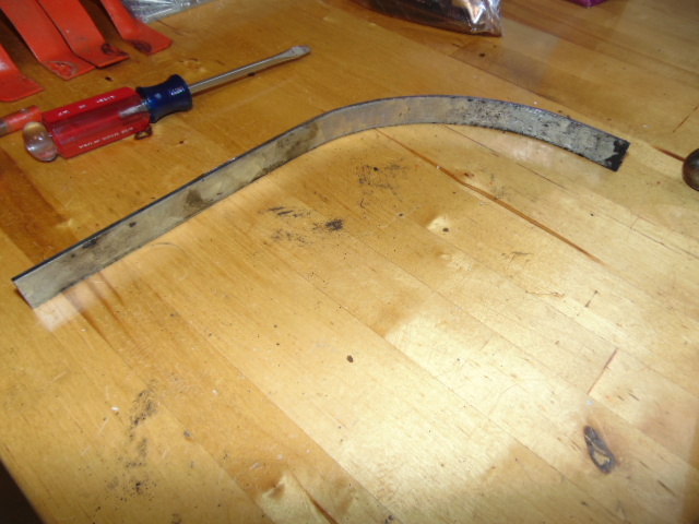

If the brake drums are in good shape and you only replace the brake bands, make sure you clean out the housing really good.  This makes getting the new band in a lot easier.
I made a tool from a piece of flat stock to scrape all the junk out of the housing.  There's a a hole in the bottom of the housing where debris can fall out.  Compressed air or a shop vac will help.
